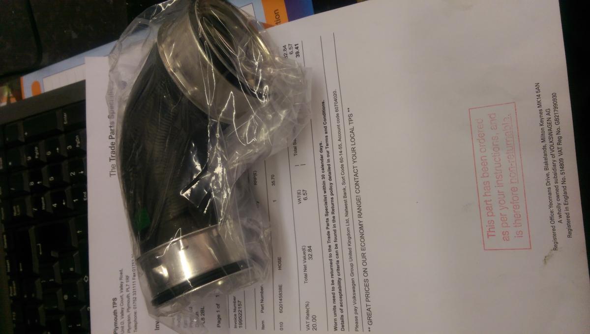

Pipe has a arrived! Seems to be correct tho havnt gone out to see. So could be the wrong one. Looks like either the bottom intercooler hose or the one that comes off Egr but. £32 quid. Yeehaaaa check out the pic.
RRP £35.70..Get in there Boys & Girls!
