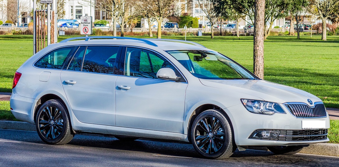

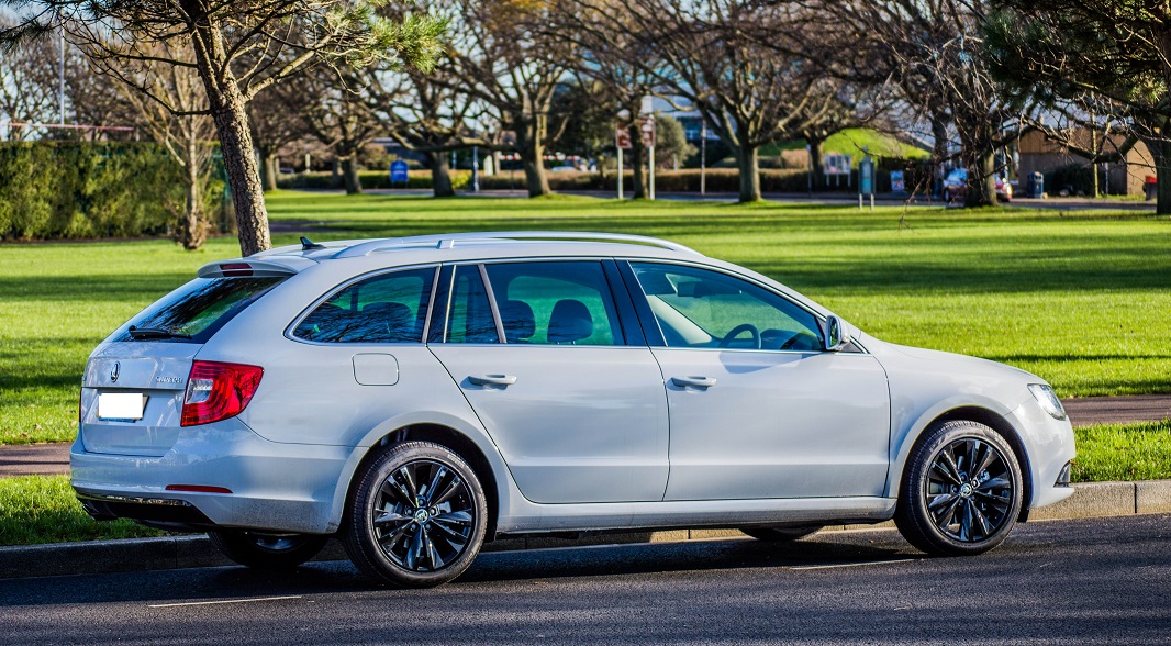

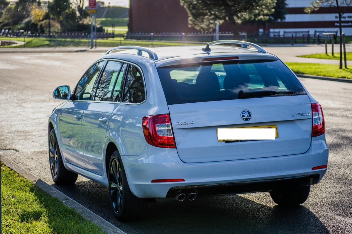

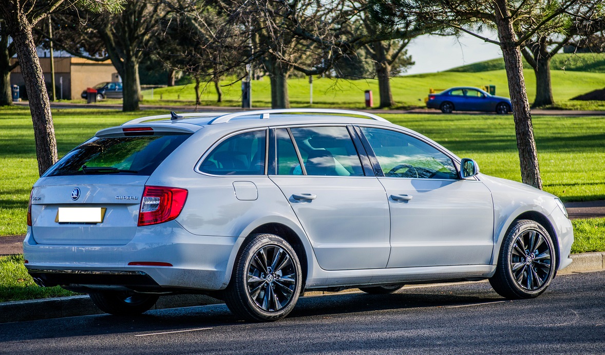

Here are some pics of my USS- Enterprise NCC-1701:
-the white balance is quite off but..
I'm not normally a fan of black wheels but there is something about the white and the fact that it is a combi that makes it look very well!  Good luck with the dealer...
