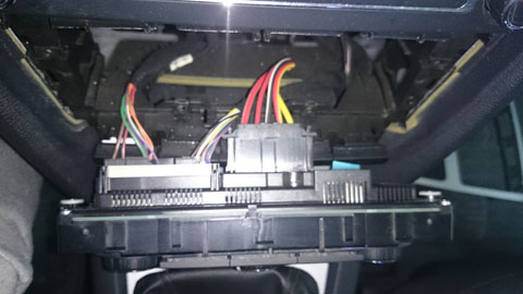

I have managed to take off the aircon/heater Climatic control unit from a Skoad Octavia 2010 face lift version.
Its part number is 3T0820047M and you can see it here: http://www.ebay.co.uk/itm/SKODA-OCTAVIA-CLIMATE-HEATER-CONTROL-UNIT-3T0820047M-3T0-820-047-M-/161510860245?pt=UK_CarsParts_Vehicles_CarParts_SM&hash=item259acc25d5
THe problem is that speeds 1 nad 4 are not working unless you press the central wheel inward.
I have removed the torx screws on the back of the unit but cannot figure out how to dismatle it further to expose the interior.
Any ideas?
Thanks

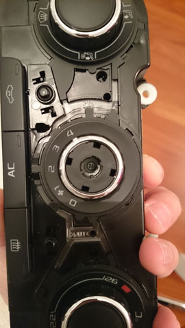

First I removed the center switch (fan speed) cover by pulling it out with a small flat screwdriver into the existing recess.

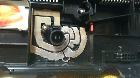

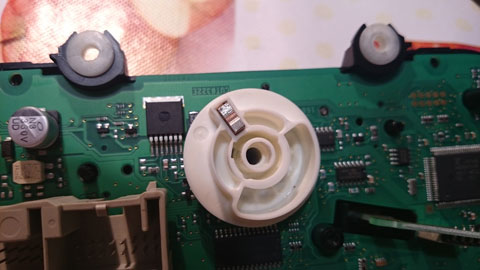

Inside of the knob there are 2 small black clips holding onto the white plastic ring. In my case they were broken and since their purpose is to keep pressure of the contacts  between the slider and back plate, the contact was not fair and therefore some fan speeds were not working.
Furthermore due to poor contact there was some arcing which build up some carbon deposites on the contacts but same were cleaned with some fine sand paper. Originally the contacts were covered with some grease (should be some dielectric type) but since i had at hand only some lithium grease i used that one even that one should not be a good choice.

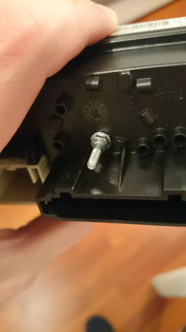

In the end good contact was reinstated by a M3 bolt trough the center of the fan switch.
