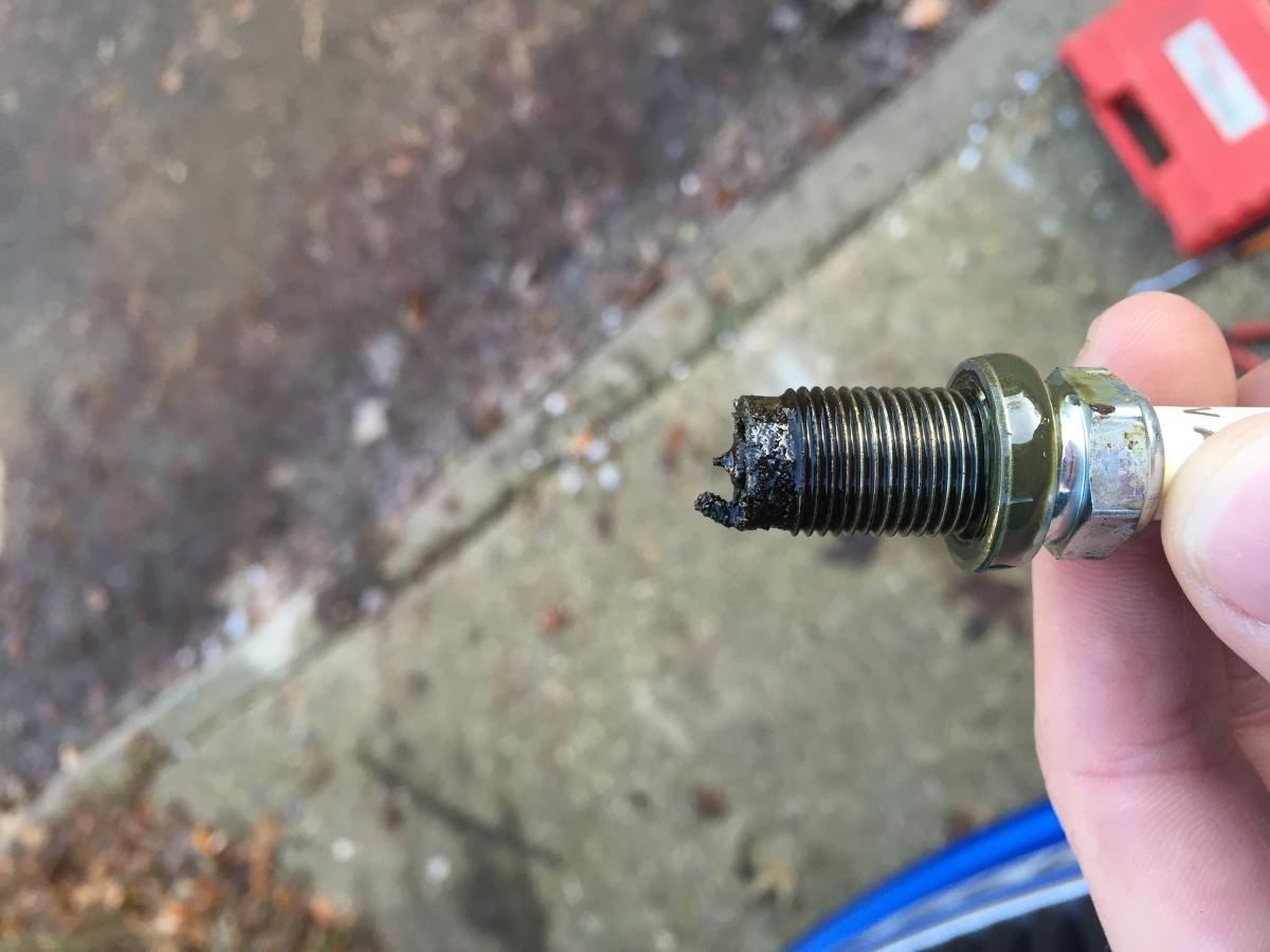

Driving home Friday night and my engine went bang, car juddered and was running really lumpy! EML and EPC light came on. So on the hard shoulder I went! Good old dad recovered me home!
In the morning wizzed the spark plugs out (as I changed them about 2 months ago!) and the bottoms missing off one with a lot of srapnal in the bore with what looks like park of my spark plug (the ones it's meant to have, platinum tipped) has made itself at home in the top of my cozy piston... potential timming chain slip? She's only done 35,000 miles. I brought it when it had 11,000miles. I've only ever let Skoda touch it for all of the work it's had. Which has just been servicing, DSG gearbox recall and a new DRL. It doesn't use to much oil and have never let it run low on water or on oil. So I havent a clue why this has happened with so little miles?!

To have the plugs overheat and melt as Fabman22 has just had requires some serious heat. Plus since he only just changed them means can't be the plugs.
@fabman22 which plugs did you use? Can you take a picture?
There is serious heat of one cylinder when up to temperature and then you are on Super Charger & Turbo,
that is the design fault, & the importance of the Engine Management being correct,
and then the plug starts failing, or the coil is, and there is a misfire in one cylinder.
That is the issue.
If you look at the various historic engine failure threads, there are the various burnt out valves, plugs and failed plugs
and holed pistons.
This is from the 'serious heat'.

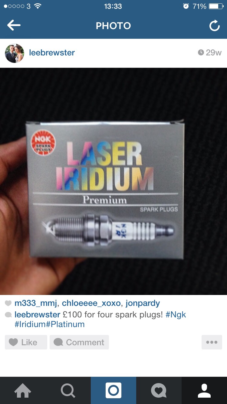

These are the plugs Skoda told me to get... They were £100 for the 4.
And then the plug I removed Saturday morning.

Do you have an Invoice for the Spark Plugs that were fitted.
Can you put up a Part Number for them please.??
Did the Dealership fit them at a charge of £100 including Parts (4 plugs) & labour (+vat)?

I scoured them myself I will attach a photo of the invoice when I get home tonight.
No no the spark plugs were £100. I fitted them myself :)

£100 for 4 Spark Plugs was a really Crazy price,
i used to spend £65 for DENSO before they were reduced at ECP.
They were worth every penny of the £65, because they are quality.
Are they PZFR6R, which are around £40 for 4 usually?
