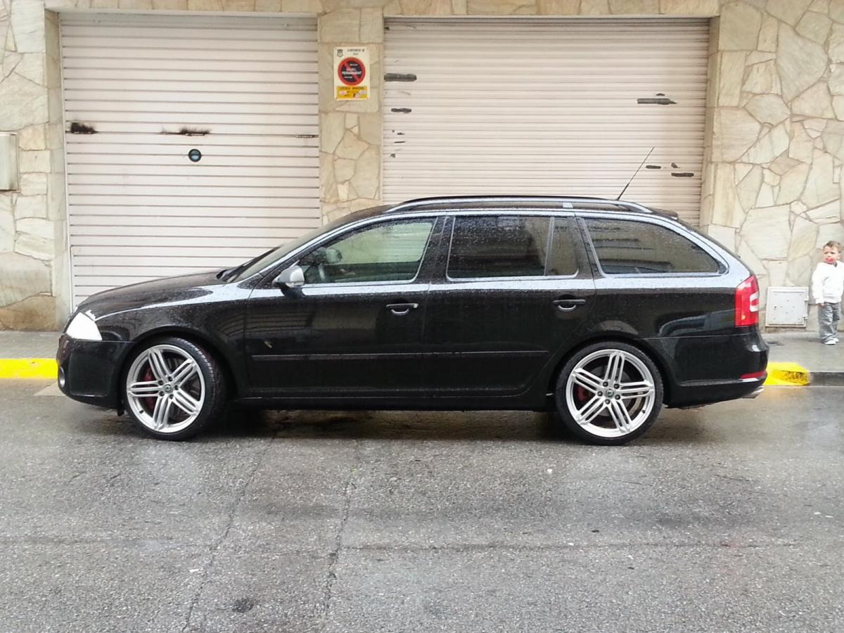

They are noticeably better than the non-vrs brakes so am quite surprised you say that. I went for the bigger vrs carriers and disks on my L&K last year when the disks needed changing and am glad I did. Are you sure its not just the warping of the discs that makes you think that.
R32/S3 brakes are minimum requirement.
345mm fronts and 310mm rears.
819E1DD1-6235-4258-A4F9-45B5DE7C155C_zps

Easy to fit?

R32/S3 brakes, calipers and carriers a good upgrade though....would handle alot more than a mapped TDI could throw at them.
Direct fit. Takes 10 min a corner more than a normal pad/disc swap. I used to have TTRS calipers which were brembo 4 pot and 375mm discs and the R32's are better.
What year r32 are the brakes off?
2006-2010? Something like that.
Have a look for Audi A3 3.2 brakes. There the same but normally about £150 cheaper.
For full setup you should be paying about £500 all in. You do need R32 braided hoses though.
