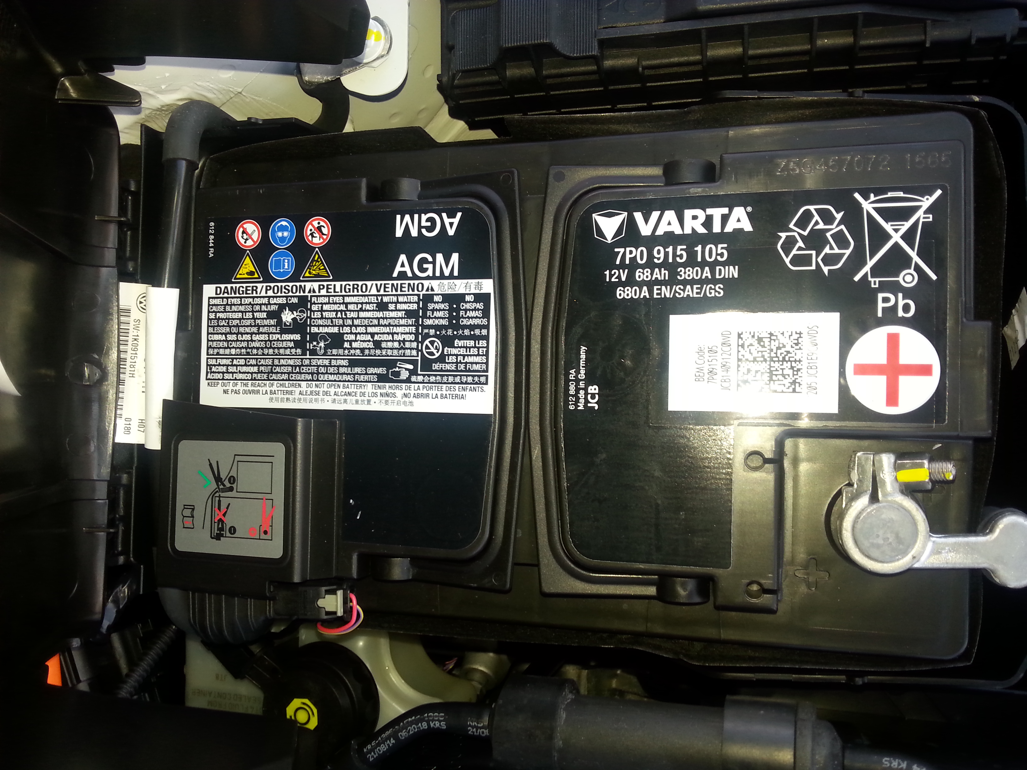

Test drove a TDi170 estate elegance today in Sweden. Still waiting for my own. Had to check the car battery, it has a Varta battery.
Here is some pictures, are the specs ok for its electronics? There was some problems with the battery during the winters in other threads?
Sent from my GT-I9300 using Tapatalk
Looks ok to me: Cold Cranking Amps are nice and high. Overall capacity is lower than you'd expect, but you have an AGM battery there, which is quicker to charge than a traditional 'wet' battery.
One downside to AGM batteries is that they don't generally last as long as traditional batteries, so just keep an eye out for cold starting problems.
Agm will also cost double lead acid to replace. Agm are now standard on cars with stop start technology.
