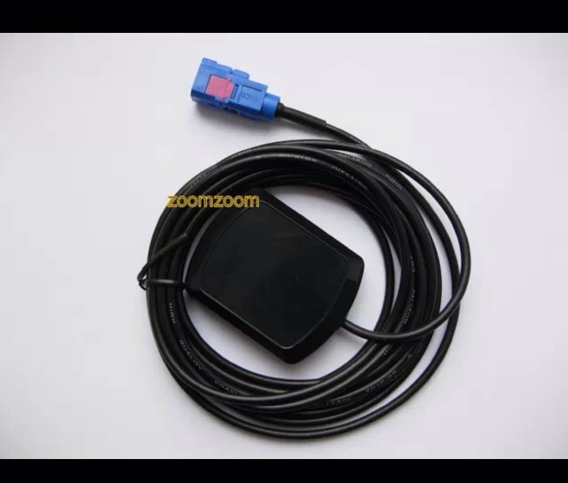

The Fakra lead came with it. With it being magnetic i put it on top of the HU  could this be the problem? Satnav works parking sensors phone

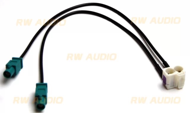

Mine isn't magnetic and looks like this:

Some confusion going on here. The magnetic thing is the Fakra GPS antenna and not the aerial adapter. I would move the GPS and locate it somewhere else in the dash, away from the actual head unit. But it doesn't sound like this is the problem really, so I'd be looking at the aerial connections.

that was already there thats what i plugged in

The magnetic GPS aerial really needs to sit high up, perhaps in the void under the dashboard. The Octavia has a cross member that you can attach the GPS aerial to, the Rapid should be the same. On top of the HU is not ideal and you could in certain circumstances lose the the GPS signal all together with it down low.

Is this the part you mean?
That would be best to bury it up above behind the HU. Hopefully it might stop interference.
Yes      There is a hole up inside the dash. A member has siliconed the gps ant there i tried this but when i close the two air vents in the middle of the dash they only close halfway as two rods push on the gps ant

The columbus has two radio aerial connections on the back next to each other, you could try moving the connection to the one next to it.
The white plug has two female plug that fit to the two male sockets on the HU and it only fits one way
That's correct. One is for AM and the other is FM.
