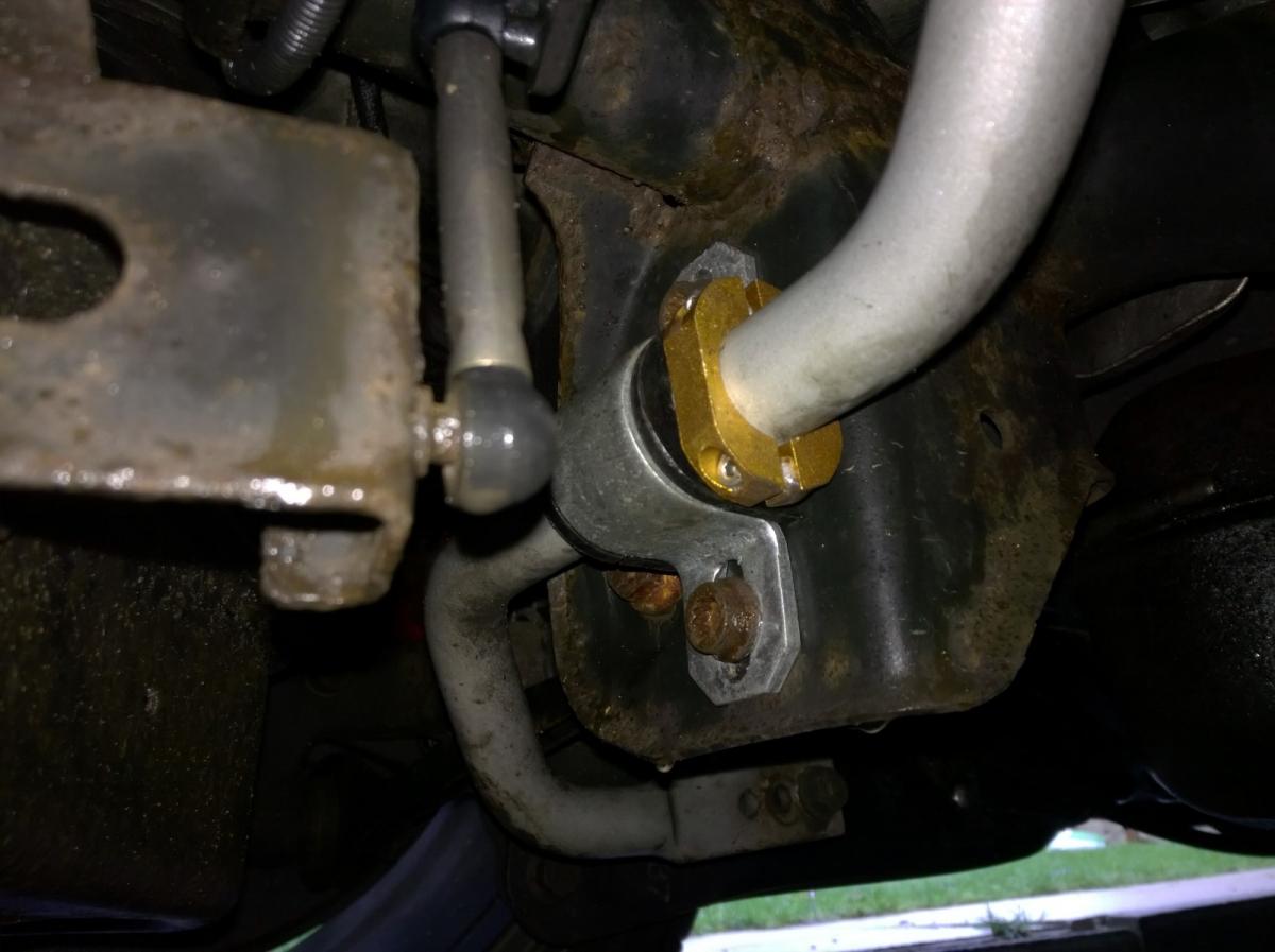

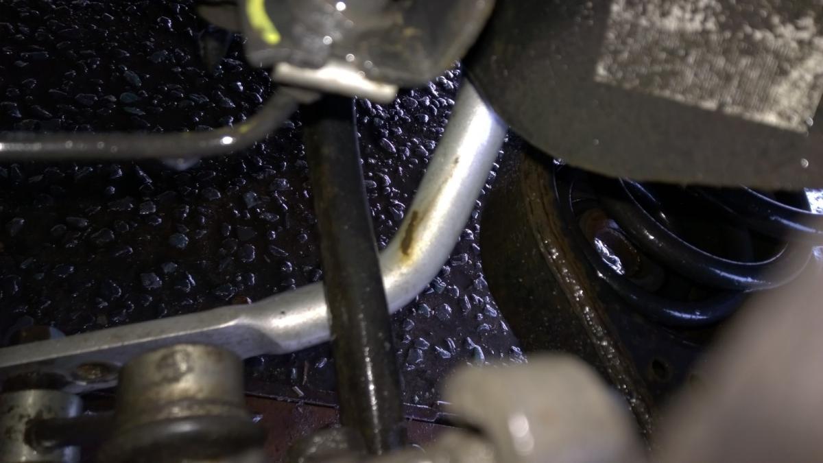

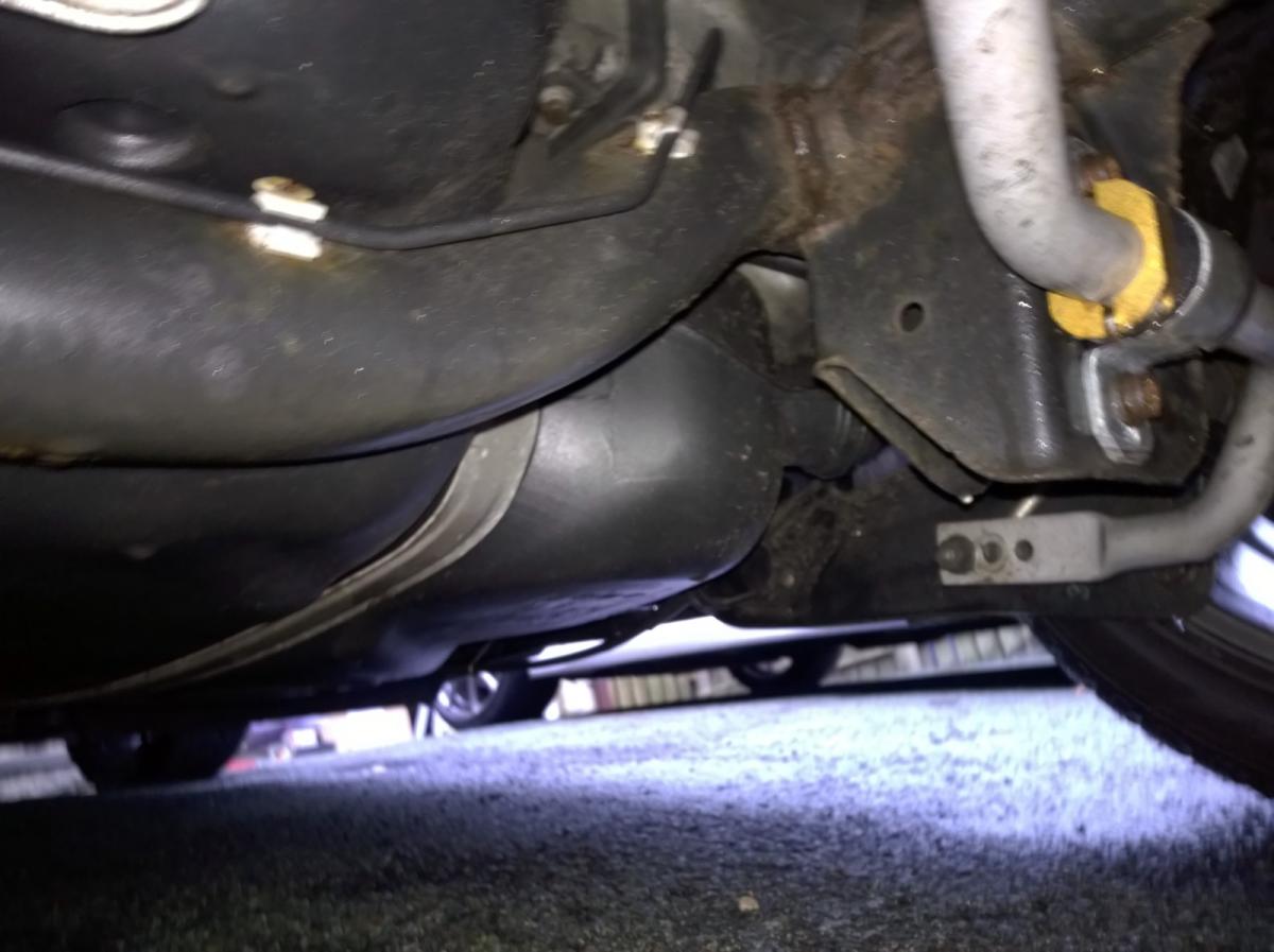

Hi, had a Whiteline RARB fitted for a few weeks and had a clunking coming from the rear passenger side when the car fully loaded on bumpy roads. Looks like it's the RARB hitting the suspension arm as can be seen from the attached photo showing a rusty spot where contact is being made. Looks like the bend in the RARB isn't as aggressive as stock so there's less clearance. Anyone seen anything like this, seems there are plenty of happy whiteline customers on here...

Don't see how it could be fitted incorrectly TBH (other than upside down which is unpossible) and yes, it's the right version for the vRS.

Hmmm, looking at those photos there's a lot of adjustment on those slotted mounts. Have asked the garage to drop it as far low as it will go and see what difference it makes.

Have you checked the drop links? They can knock when worn out.
It's worth having a look at the clamps on the arb to make sure they aren't rubbing on the sub frame mounts.

Worth dropping the mounting here's how mine are mounted http://www.briskoda.net/forums/topic/320041-suspension-noises/?p=3943622
