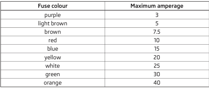

From a 2014 handbook, fuses 17 & 25 are to do with the washer system. Located under the dash below the steering wheel.
Depending on the colour of fuse, the amp is;
