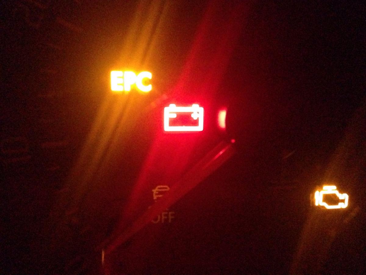

Thanks, it's strange that it's not as bright, I had taken a picture but I don't know how to post. Where do I switch the traction control on or off? The handbook shows a switch I don't have. The dash symbol is a car with two skid lines and the word off underneath it

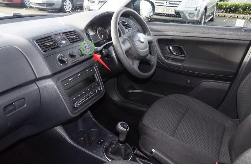

If youve got a button, itll be above the rear window heater button
I don't have a button then, so how do I switch it back on?
You can't, if you haven't got a switch then you haven't got Traction Control.
If you had TC then the button would be next to the rear window demister button where the heater dials are.

Thanks, seems ok to me but I only picked it up on Thursday and came from a diesel mini! The light is very dim, what would cause it then? Is there stability control? It's a 2013 Monte Carlo, 11k on the clock
You can just about see it in this pic

It only has TC if the button I circled on the picture is present above the rear window heater button, that's the only way you'll know if it's fitted.

I've been looking at the wrong light, EPC stands Electronic Power Control so could be a number of things ranging from fuelling ie; throttle bodies to braking so defo needs to be checked out.
It's not the TC light as that looks like a car swerving.
It is the TC light mate.
Its faintly lit behind the needle if you look carefully
