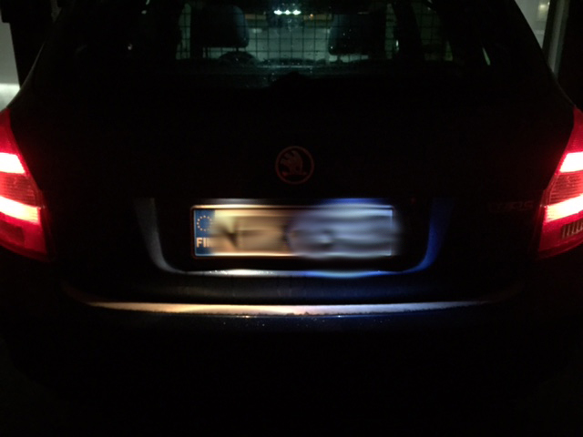

Hopefully this has not been shared yet. I got totally tired of messing around with Led license plate bulbs already with my previous Octavia.
Blown bulb errors, no matter how many can-bus Led's I tried. I finally soldered a normal bulb along the other license plate light. No errors, but flickering after a couple of weeks.
Now with the Fabia, errors again... finally found this on Ebay:
http://r.ebay.com/S6770n
A set of blue coloured normal festoons, YES! No errors, no flickering, look like LED's, but not too much light like some LED's tend to have. Hopefully they last :)

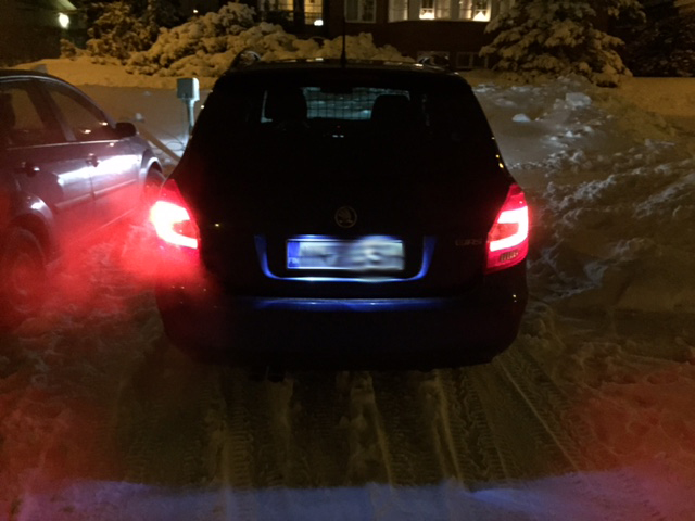

Maybe just a little bit too bluish for my taste, but a lot better than regular ones. See pictures attached.
