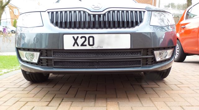

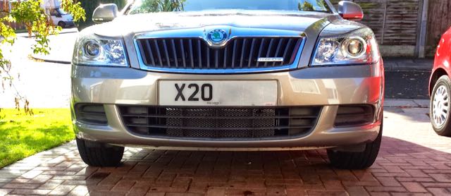

After forking out loads of cash for a new air con radiator on my Octavia Greenline 2,  I fitted mesh behind the grill  and problem solved.
I upgraded to Octavia Elegance 3 and the only way to put mesh behind the grill is to remove the front bumper. Not really wanting to do that and weather conditions, I resolved it, by fitting the mesh externally.
I know the purists amongst you won't like it, but it gives me peace of mind and it was less than £30.

Aluminium black mesh grill 16x10 Bmw Seat Skoda Vw 100 x 25cm £13.99 inc delivery it’s from Poland arrived in a week more than enough to do the job.
carbodydesign_eu
I also bought 4 meters of black plastic edge trim 0.7mm to 2.5mm grip range £14.65 inc delivery arrived in 3 days, you could get 3 meters I had well over a meter left over.
 J AND S SUPPLIES ebay

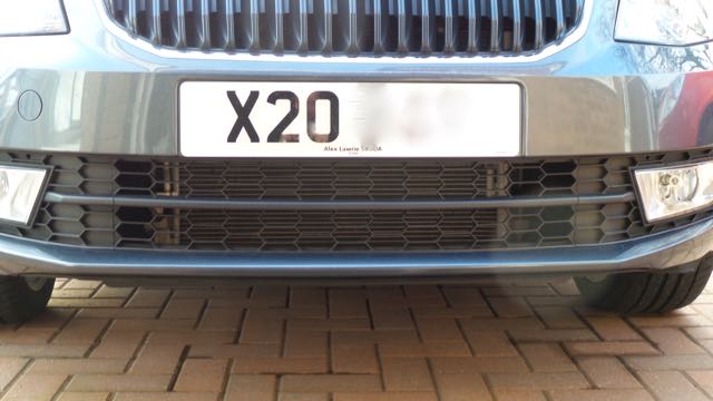

has anybody found an easy way to access this and to fit a bit of mesh behind the lower grill/in front of the air con radiator?
