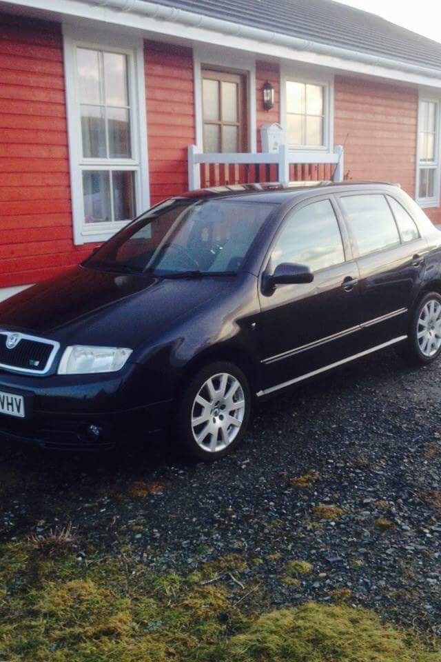

I recently purchased a 2004 Fabia vrs in black. It was a spur of the moment purchase, and only after buying it I realised how much I love it.
I picked it up for £1000, but does need some work.  86k miles ( serviced up to 75K)
I am starting to sort the car out as it has some issues.
1 - No power steering - Orange warning light is light up on the dash
2 - Battery going flat over night (I am pretty sure this is linked to the power steering)
4 - ABS light on - ( had new calipers fitted recently - maybe a sensor not working right?)
5 - Paintwork is feeling gritty ( any suggestions?)
6 - Needing new Front tyres (will Toyo Proxes Be Okay?)
Getting the car plugged in this Weekend and hopefully I will have a better Idea on What its going to Cost to put Right.
After fixing it mechanically I will have a look at the interior and Exterior.

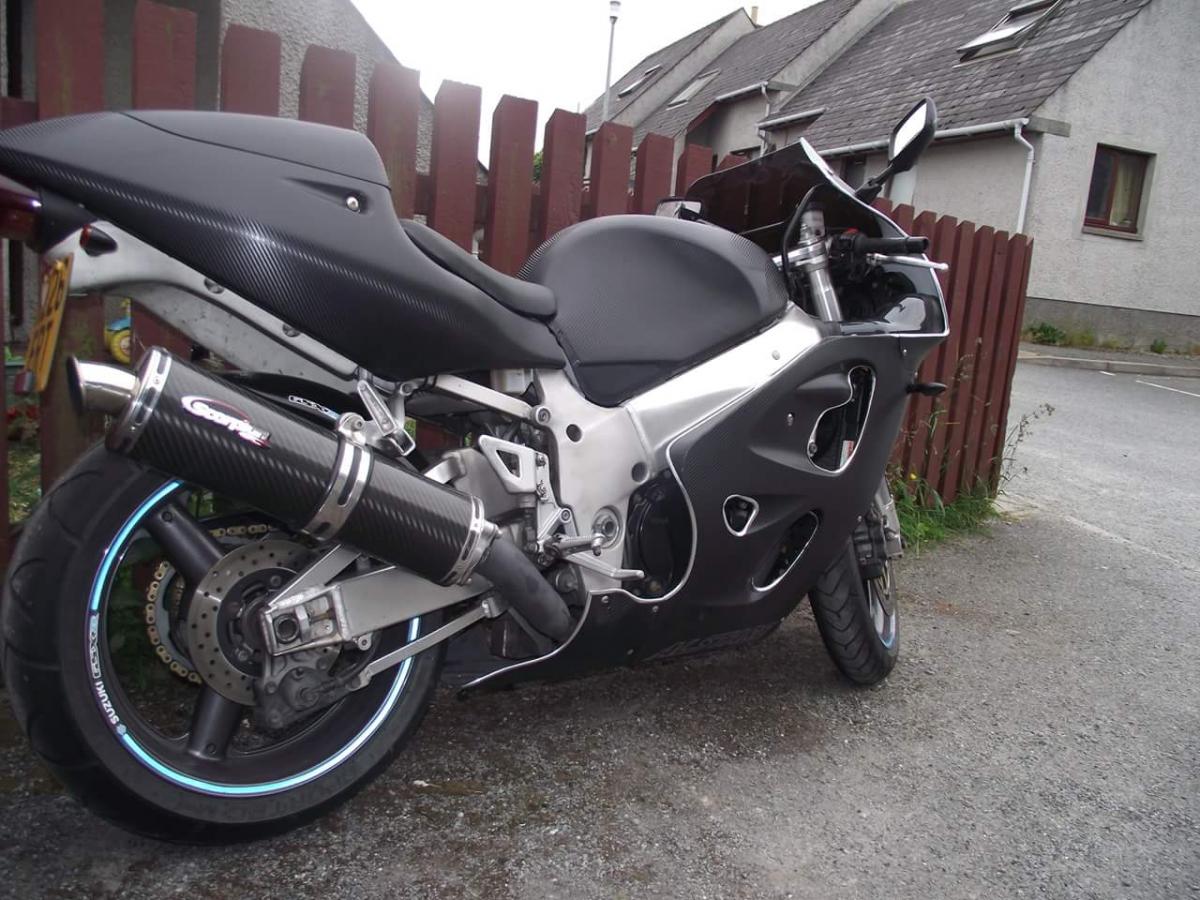

I'm going to de-chrome the fro t grill. What do you guys suggest as the best method. I have worked with vinyl wrap allot, managed to wrap my gsxr750 in full carbon effect so will be easy.
Another thing I was thinking was plastidip. Or just plain old spray paint.
Thanks
post-126401-0-85944600-1422736715_thumb.jpgpost-126401-0-96997400-1422736728_thumb.jpg
Thanks
Spray paint but strip all chrome off first
