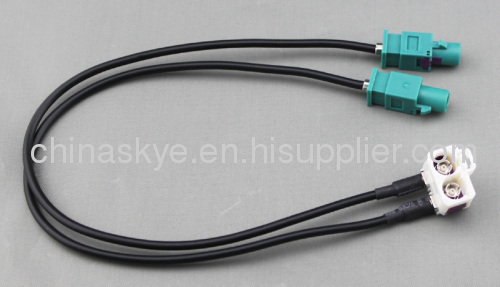

I'm pretty sure you should have two antenna connected to the previous stereo (double white FAKRA connector - see picture but ignore the green bits).
If not, what did you have on the end of the cables that end in white plastic blocks and connect to the aerial inputs on the back of the stereo?

Thanks for all the suggestions. My car is a 2005 Octavia with a single roof mounted antenna and a single aerial lead to which I have fitted a fakra adapter lead to convert from the single lead to a twin plug which plugs into the back of the HU. I have recently replaced the roof aerial. The radio reception is virtually non existent.

Remove the adapter.
Plug the one aerial cable into the double connector on the Columbus. Put it in the part nearest the GPS connector.
