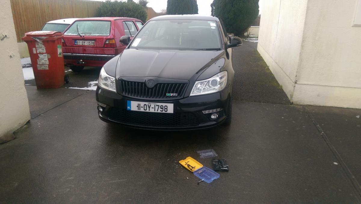

Not sure if i should fit a new badge.also is it hard change the rear?

Something needs to go there, it looks as though it's fallen off or been nicked! :D

the rear is very easy to get off if you protect all around it with a couple of layers of gaffer tape as per above and heat it well with a hair drier first to soften the double sided tape underneath it. The tools above help prevent damaging the paint and are well worth getting IMO. The rear also has the correct locating pins too which makes it a doddle. I did mine front, back and wheel centres. The numbers Alan has put in his initial post are the right ones, but if you search on ebay check the numbers the search brings up as it will also bring similar ones up too further down the list. I got the wrong one so had to send it back with was easy to do but worth avoiding.

thanks i will have a look at them now,are the numbers a direct replacement for the old badges or is there some modification needed.i should have done it when i was painting the grill as i have to drive it like this now till they get delivered :(
