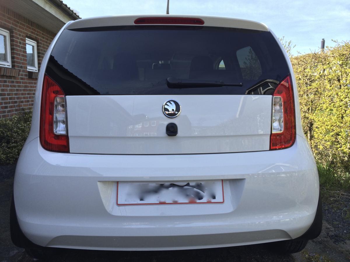

I removed the "Skoda" and the"Citigo" from my car, they are sticked on with som kind of tape, I used a piece of dental floss and worked/floss'ed my way behind them and of they went. There where some sticky stuff left on the hatch, but I removede it with my fingers and some kerosene.
I believe its the same with the 2 badges, I have seen some Citigo with the badges removed too, they look just fine

The front badge looks like it has some small dimples under it, they are visible from the underneath I can't bring myself to pull the badge off to check but are probably there to locate the badge
I saw those too but I'm so tempted to prise it off but the Sport stripe has a cut out round the badge and would look odd. I think I'll Plastidip them instead [emoji106]
