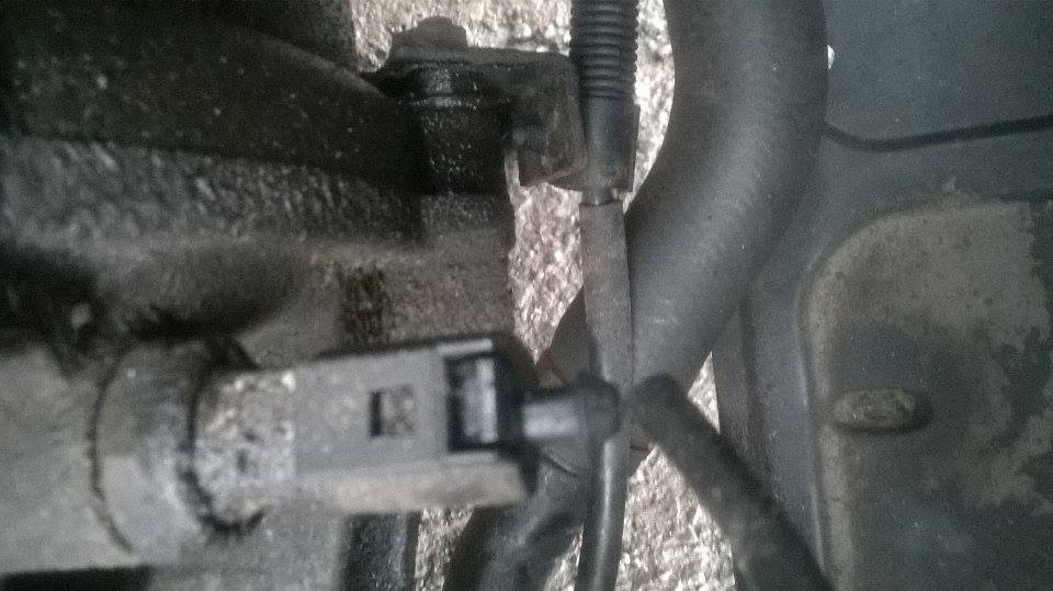

ive tried to get that pipe off in the pic but cant do i need a special wrench or whatever there called ? x

hi i thought it was this ?1

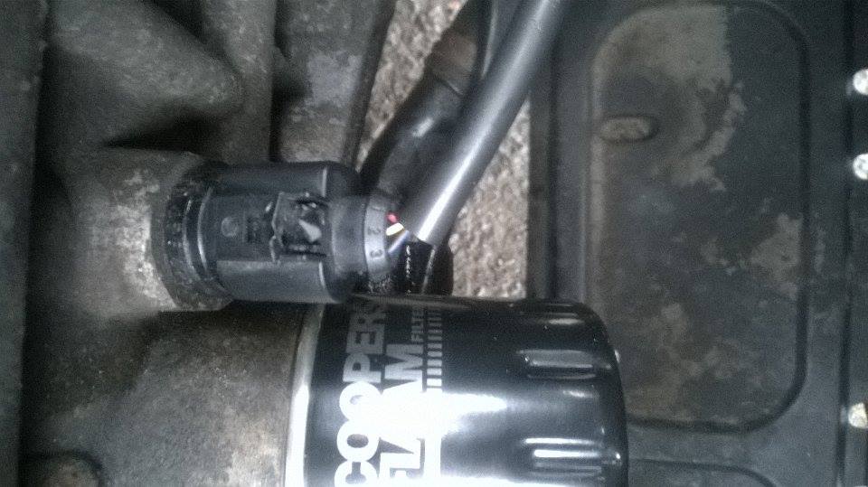

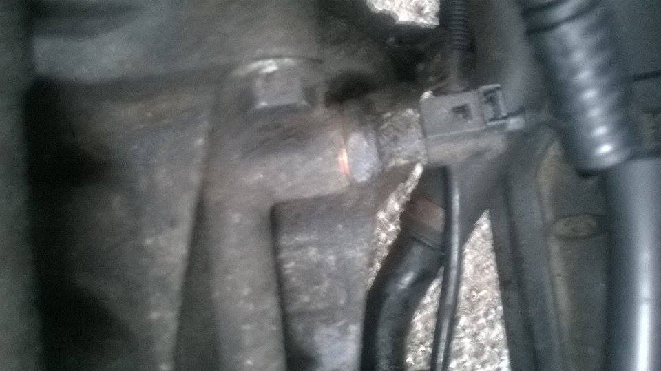

but then i seen this and its absolutly caked in oil muck i dont even think il get the plastic off
HI IS THIS IT IF SOO ITS ABSOLUTLY COVERED IN GUNK I DONT EVEN THINK IL GET IT OFF

HI IF THIS IS IT ITS ABSOLTLY COVERED IN OIL AND GUNK I DONT EVEN THINK IL GET IT OFF!!

That's the one, with the single wire.
so not this one?
if its the dirty one do you think that could be the cause of all my problems?
its wet undernaeth aswell

Yep the mucky one. The very fact that its so oily all around it makes me think you've found the problem.
I reckon the garage that charged you £90 for not fixing it need a bit of a kicking.
ahh brilliant, that sounds hopefull then , its caked in muck and i dont think il get it off , il take it back to garage on mon . thanks again x x
