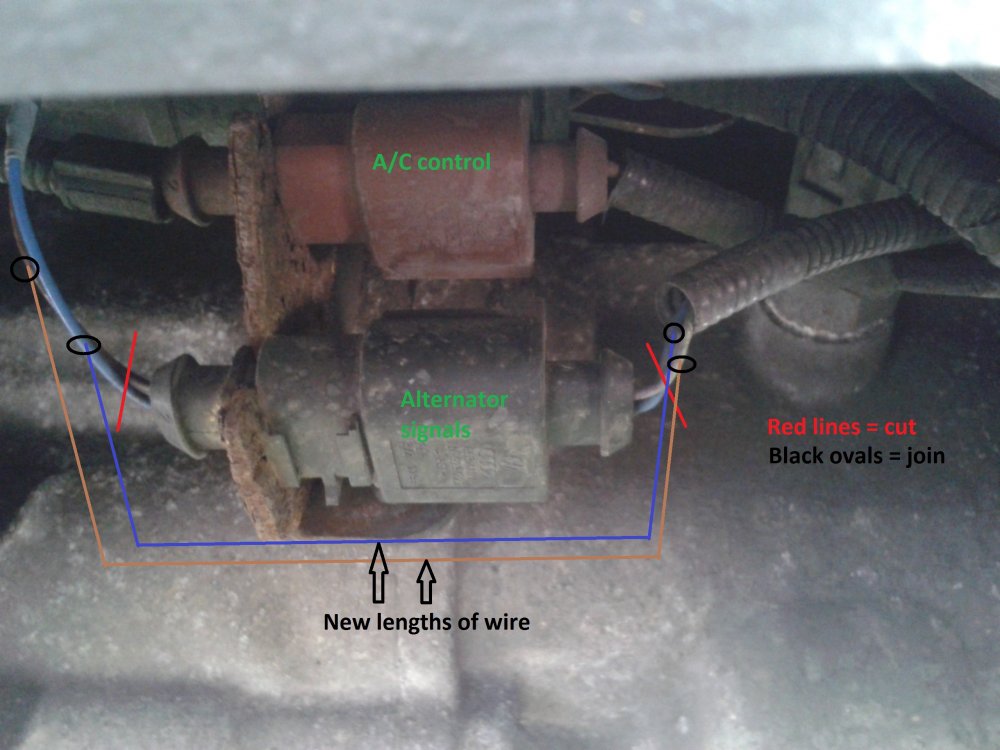

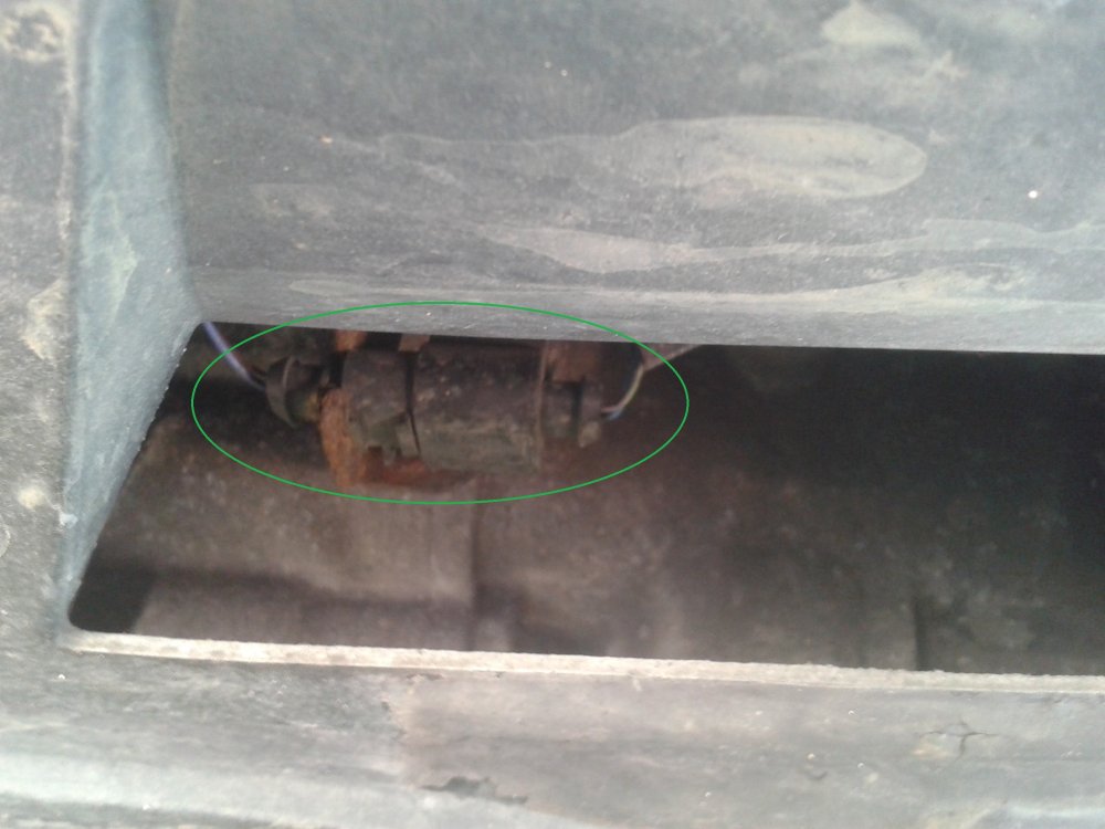

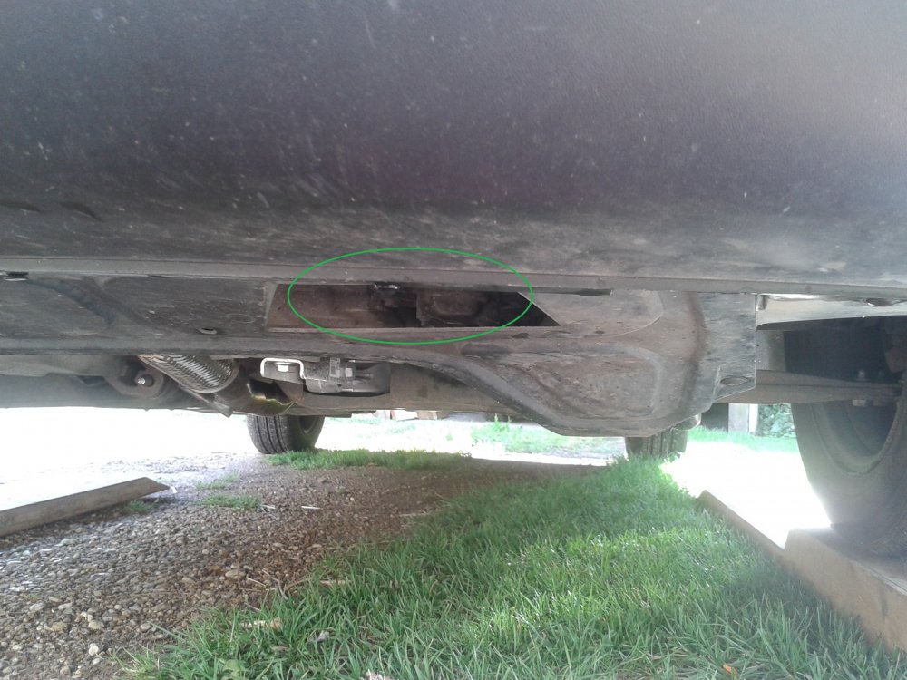

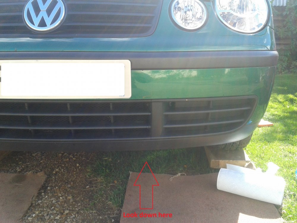

This is a Polo, but it's much the same:
 You know where you said new lengths of wire?? What do you mean just connect the wires together or do I need a new clip?
  • Sponsor
If the broken bits are long enough to just join together, do that. If they aren't, splice in some new bits to reach. The connectors aren't necessary.
Alright mate nice one!
