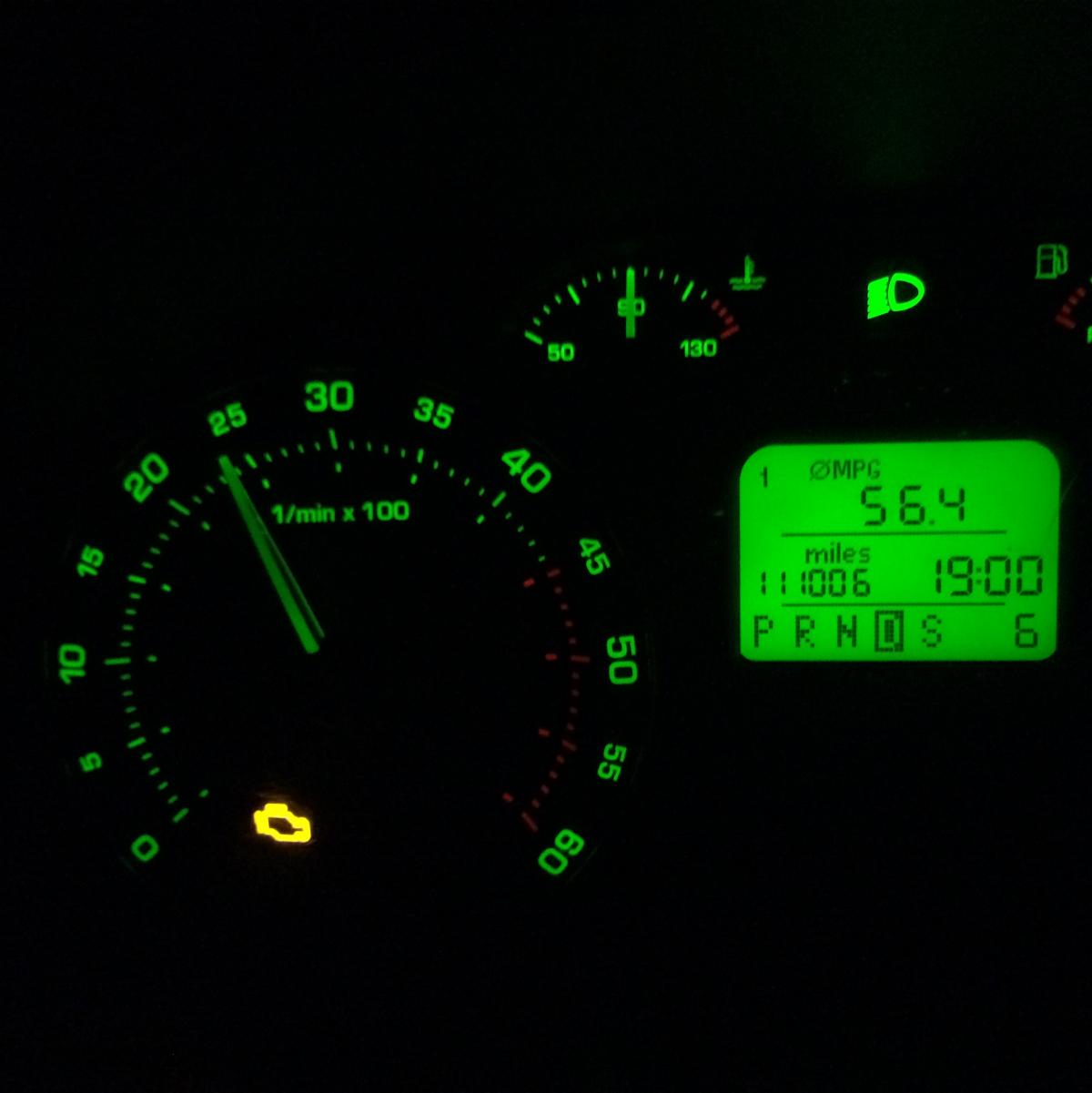

Im still waiting for the funds to be able to reMap mine but im still getting great MPG on Runs 54/56 between 70-80mph on MWays and average about 43-46 normally so im pretty happy about that with the mileage of car.
It has got marginally better since removing the EGR and cleaning the Turbo though but only 1 or 2 but more consistant.
That is probably cleaning the turbo though so things are just cleaner and smoother and easier to drive.

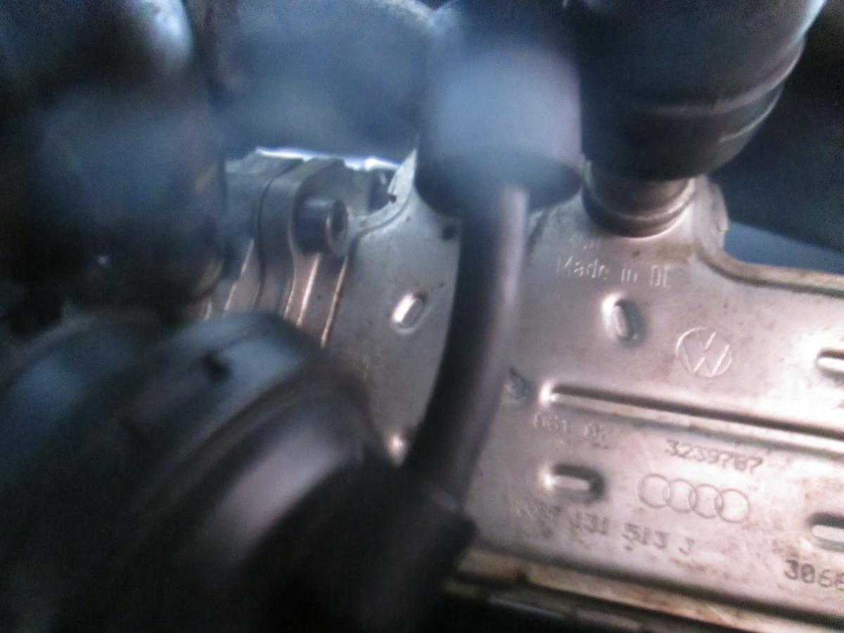

Finally managed to wiggle a small camera down behind the top of the engine and got a shot, as attached, of the back of the cooler and it is a 03g 131 513J !
I assume that another 513J would be a direct like-for-like replacement, but would a 512L require other parts such as hoses (etc.) to also be changed in order to fit it?
Edit: Update - from all the on-line pics I can see of 512-series coolers, they look physically quite a bit different and look like they need some different hoses and so on - but it would be good if someone could confirm that!
