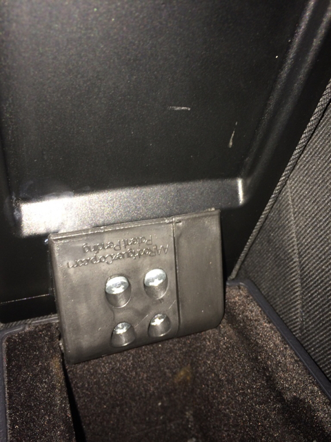

The hinges on my armrest is broken off. Its only two small plastic "taps" which is broken straight off.
The problem is here in Norway they only sell complete armrest-kits and they cost around 700 pounds to replace. Do you guts know another option for me than using so much money on the armrest?

And this fits the Fabia 2 armrest system without any mods?
It's fits perfectly on my 2011 Fabia Vrs, I followed the video step by step and it's really easy to do
What a stroke of luck.....mines cracked too & i hadn't a clue you could get replacement hinges. Extruded nylon Many thanks Mrj! that surely must be far stronger than original plastic stuff. Many thanks Mr j, Darksides only 15 mins away from me.
If you go in person they will discount you a better price they did for me and the hinge is really strong much better than oem [emoji106]
Excellent. I'll try to order one to Norway.
Done. Thank you. I've saved a lot of money on this tip, and i need them. Impulse bought a Kia Soul EV on monday.. Waiting for Skoda to launch an all electric car. A Roomster with the tech from Golf E would be perfect!
