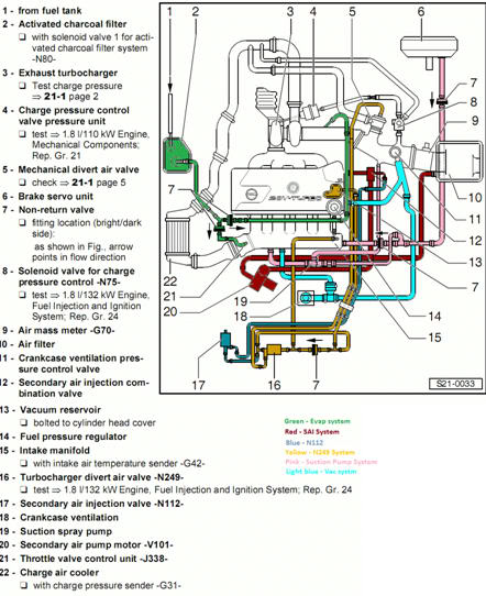

Here's a schematic of the pipes showing the different parts. The ones you need are in light blue:
