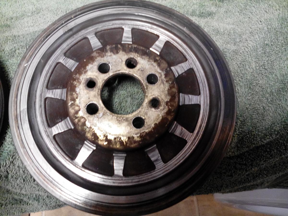

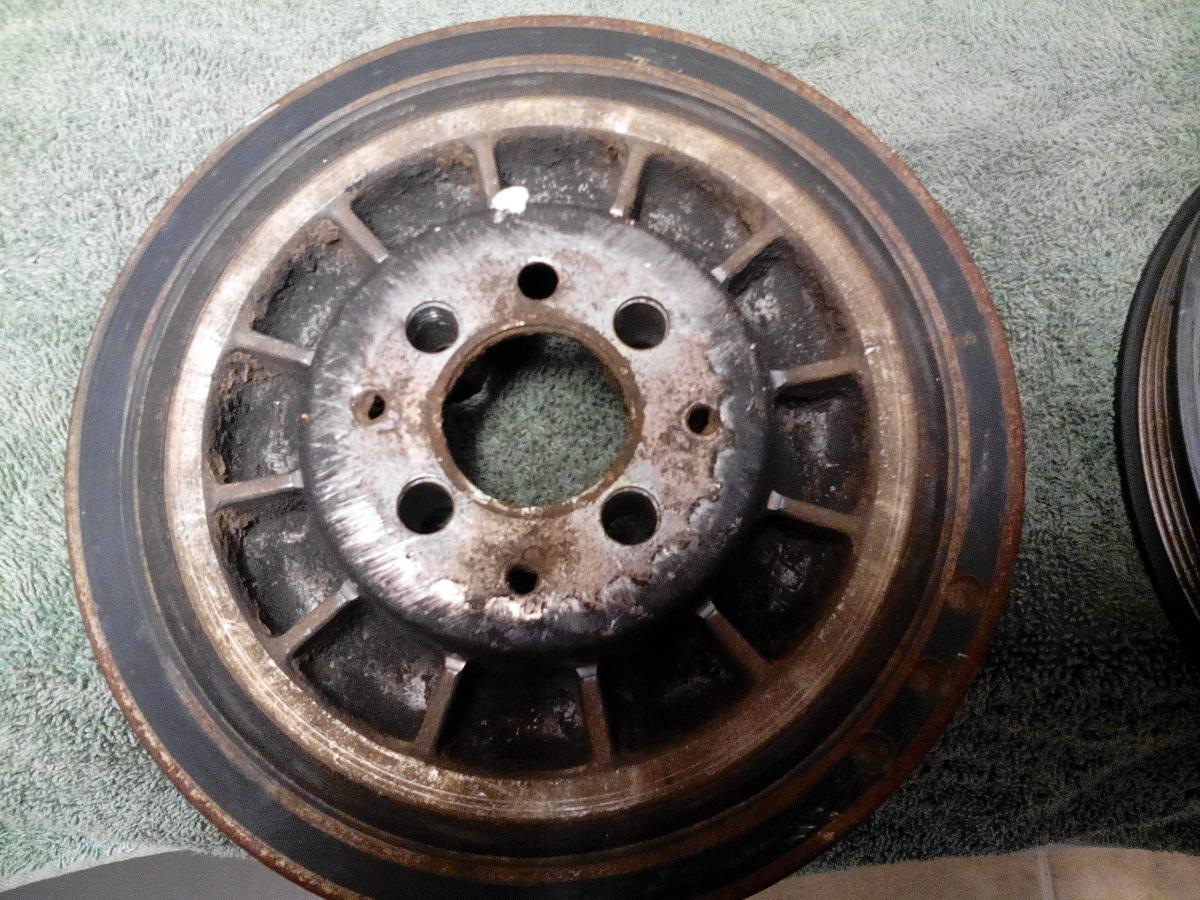

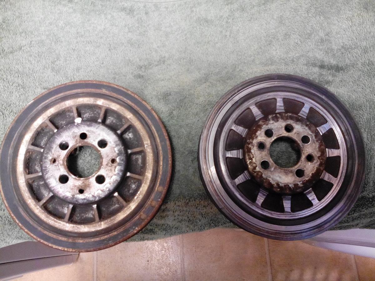

Possibly this may help see attached photographs it's difficult to see . the pulley that is polished is actually quite badly worn this was caused by the plastic belt cover caching which seemed to last  better than the aluminium . The other picture is of a good pully. Could something have jammed and slowly rubbed it away I saw a similar thing with a copper brake pipe tied up with a tie rap the nylon was perfect the copper pipe had rubbed awaypm me if you want one  clive
side by side photo
This one I have has no signs of it rubbing on the belt cover, I think it was caused by the bonding glue breaking down...
Just for info they are over £120 from skoda, but you can get them from a local motor factor as well, gates automaster do one as a pattern part which is circa £60
Seen plenty fail like that before.
Yes mate changed plenty, you are lucky it didn't take the timing belt with it, I have seen one wear away the oil pump pulley until it jammed bits under the cam belt..
