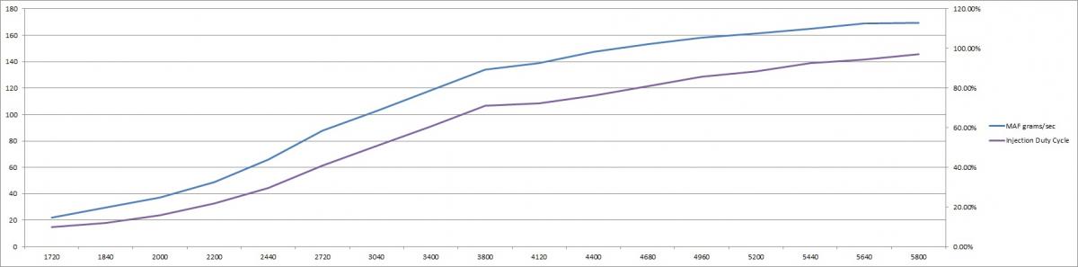

First one I've looked at which I've put into graphs.
MAF readings and injection time which I've converted into duty cycle. Going of the good old MAF / 0.8 = estimated power it would work out around the 210bhp mark. Going off that the MAF readings look ok. Logs only go to 5800rpm.

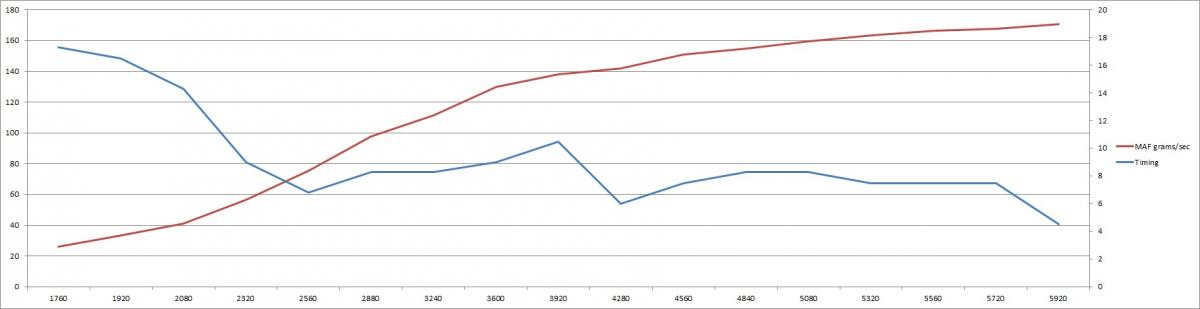

Next MAF and injection timing. Not sure on the injection timing, which in in degrees before top dead center. I'm new to petrol :)

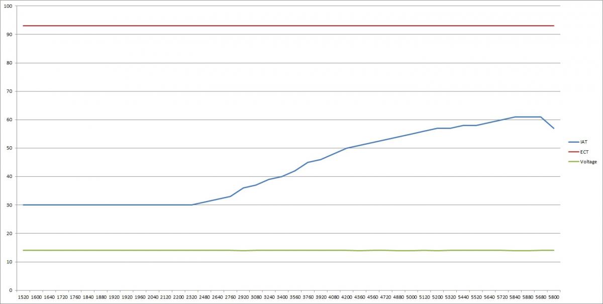

Temps

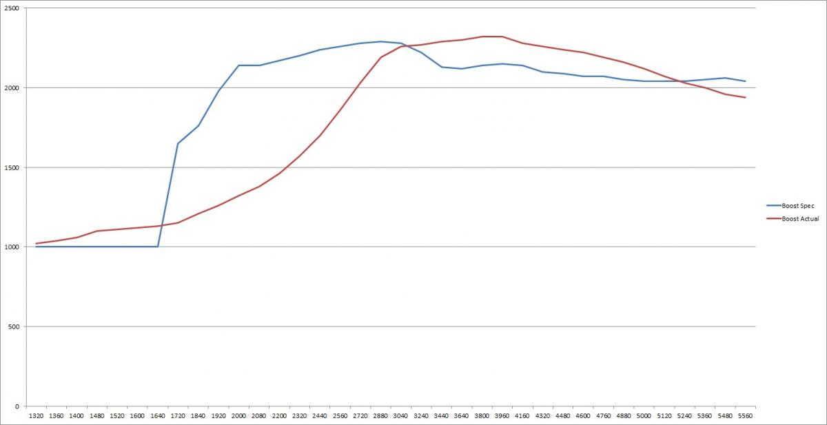

So power and MAF looks ok? How was the boost, was it making what was requested? I couldn't make much sense of those numbers.

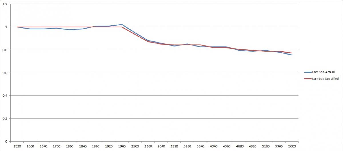

Lambda results. All looks to me which it did on the dyno.
Boost. Comes on at 3000 rpm and looks smooth to 5200 where it then starts dropping below specified. Guessing this is the actuator not able to keep the boost. So past 5200 power will start to drop. Would be good if you could do a log to the redline but not always ideal.
