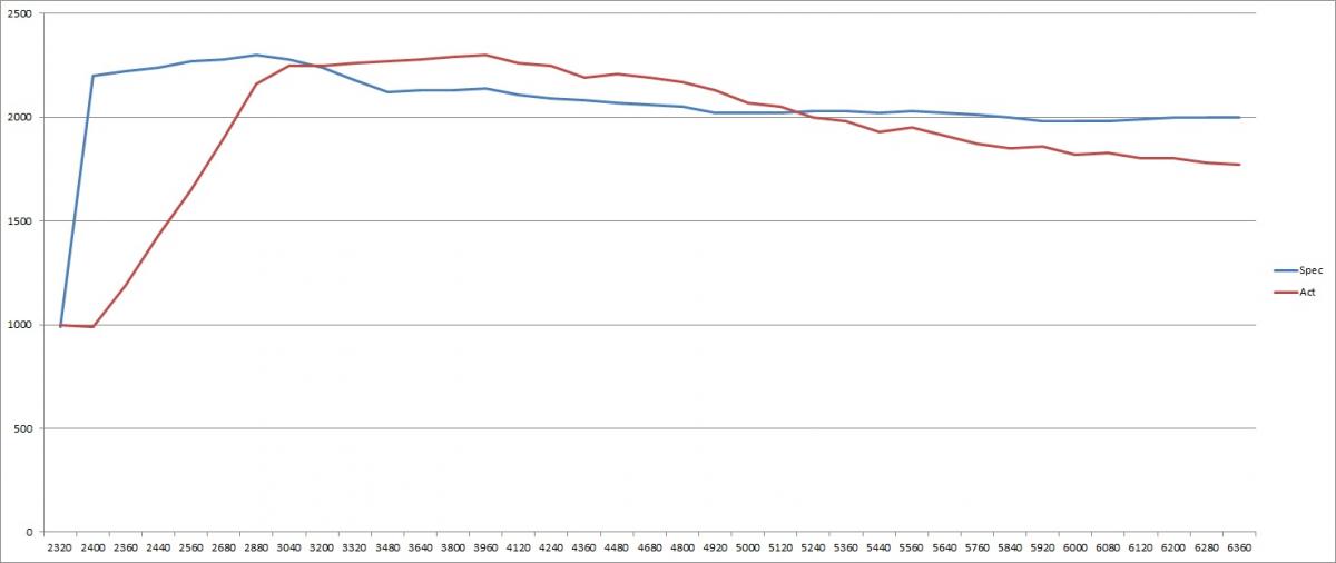

So we're getting there with the power and torque, just need to keep it up there. Why might the actuator not be holding boost? I can try another run logging boost block to redline, but I suppose we can already see it dropping off. Could that be a mapping issue? Something symptomatic ko3s turbo? Or some other problem?
Another good thing though is that these lines aren't as fluttery as the dyno run, look to be a lot smoother?

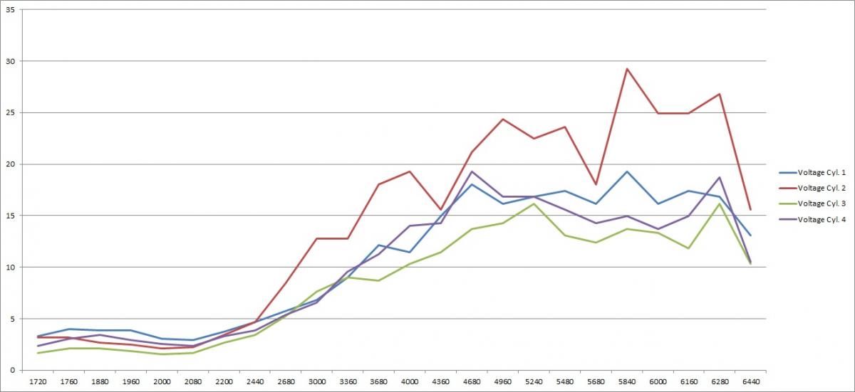

Group 26 knock voltage log.
You can see cylinder 2 is the loudest out the 4. This I believe is common due to the location of the sensor and picking up more noise. Had a little "Google" and anything below 20-22v seems to be safe.
Cheers John, so you don't think I need worry about the cylinder 2 reading?
Group 115, boost.
I wouldn't no.
Just been looking around and group 20 might be a better one for logging knock. It shows degress retard. Ideally you want none :)
Group 115, boost.
Are you still thinking actuator for that drop off? I did a bit of reading and a tired spring could produce these symptoms, my mate mentioned vanes as well.

From what I remember this would normally mean the tired spring like you say. Hows it feeling in general now. I would like to see the results on another dyno to be honest.

As I said if it is making between 205 and 210bhp as the logs suggest that's not far away from what I expected. It would be nicer for it to hold it more at the top end though. What I may do is get the actuator done and pay for a dyno run, especially if I feel it's made a difference.

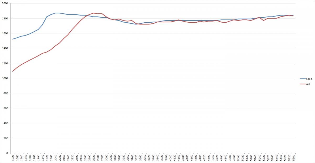

This is a log I had from someone else, hope they don't mind :)
I don't think boost low down is much of a concern, They are always below requested until the turbo comes on boost. Comparing the two your is a little lower. May be due to the actuator?
