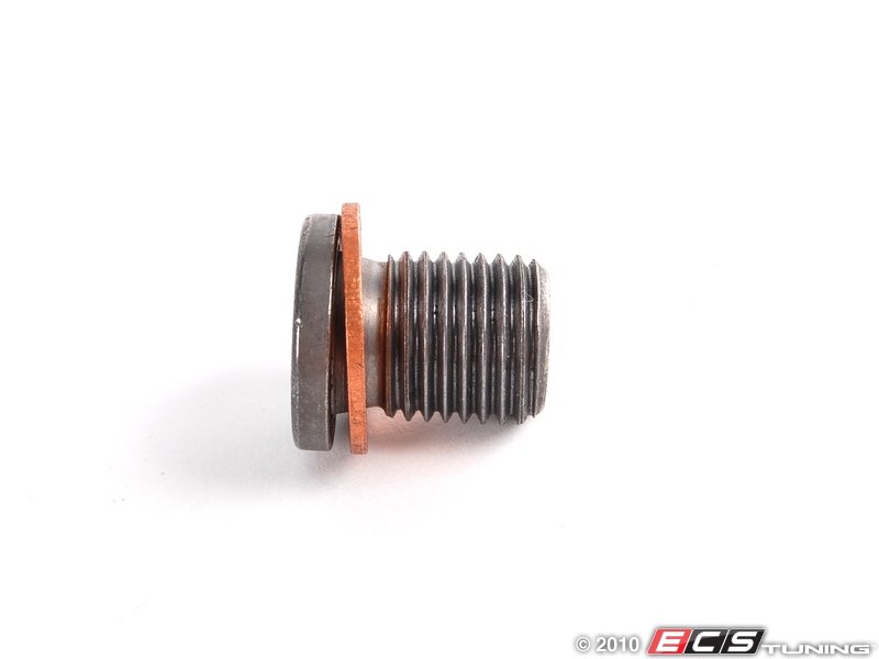

The thread is 14mm OD.  The non-threaded section is 13.5mm OD
A 14mm ID fibre or crush washer (esp the hollow donuts) work fine with these:
But I'm not so sure about these ones with the allen head (but I think it would still seal properly)
