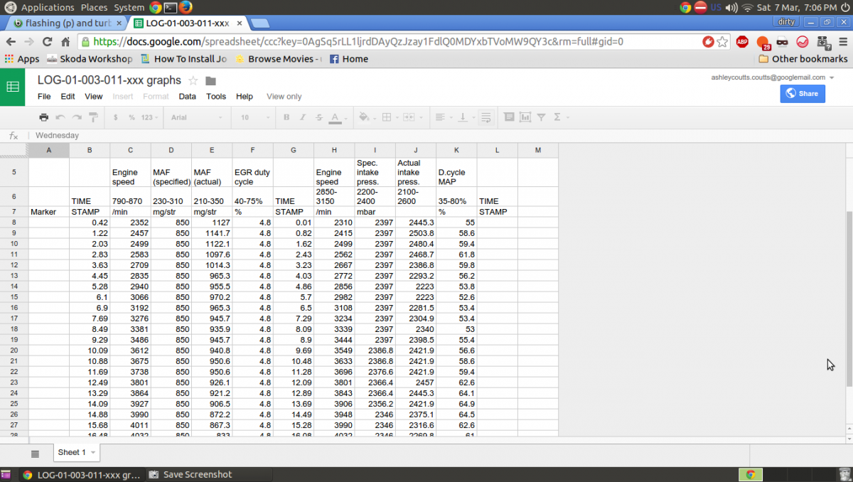

i cant see any problem with the figures below, i may be having an fuelling issue.

Slight overboost at 2400rpm but nothing major, looks like this is kicking the vein in a bit more than it should and then the turbo is playing catch up.
The veins are far from fully closed, vein operation is dcycle, and yours peaks at 61.8%, i would expect it to be reading around 72-75% at 4000rpm at full throttle.
The range your describing sounds like a problem with your egr valve, might want to give it a good clean and check the feed pipe from the exhaust manifold into it aswell for cracks.
