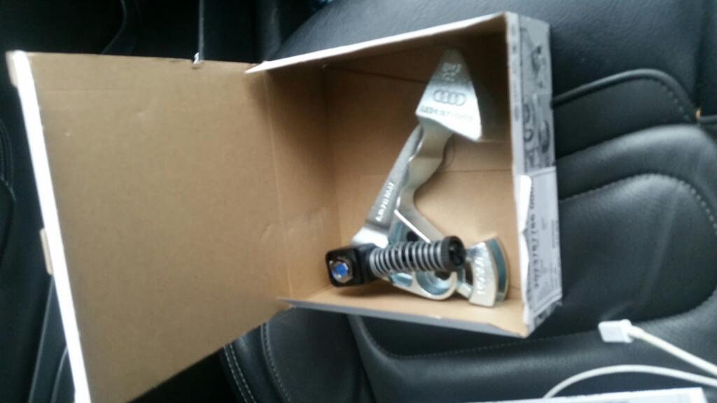

Picked up mine today..
That looks wrong.. - it looks like the 5 speed unit
I think yours should look more like this.  Just pull your airbox off & you'll know if it's right or not.
It looks identical just a different angle.. It is the correct part number
Sorry, I had a brain fart
