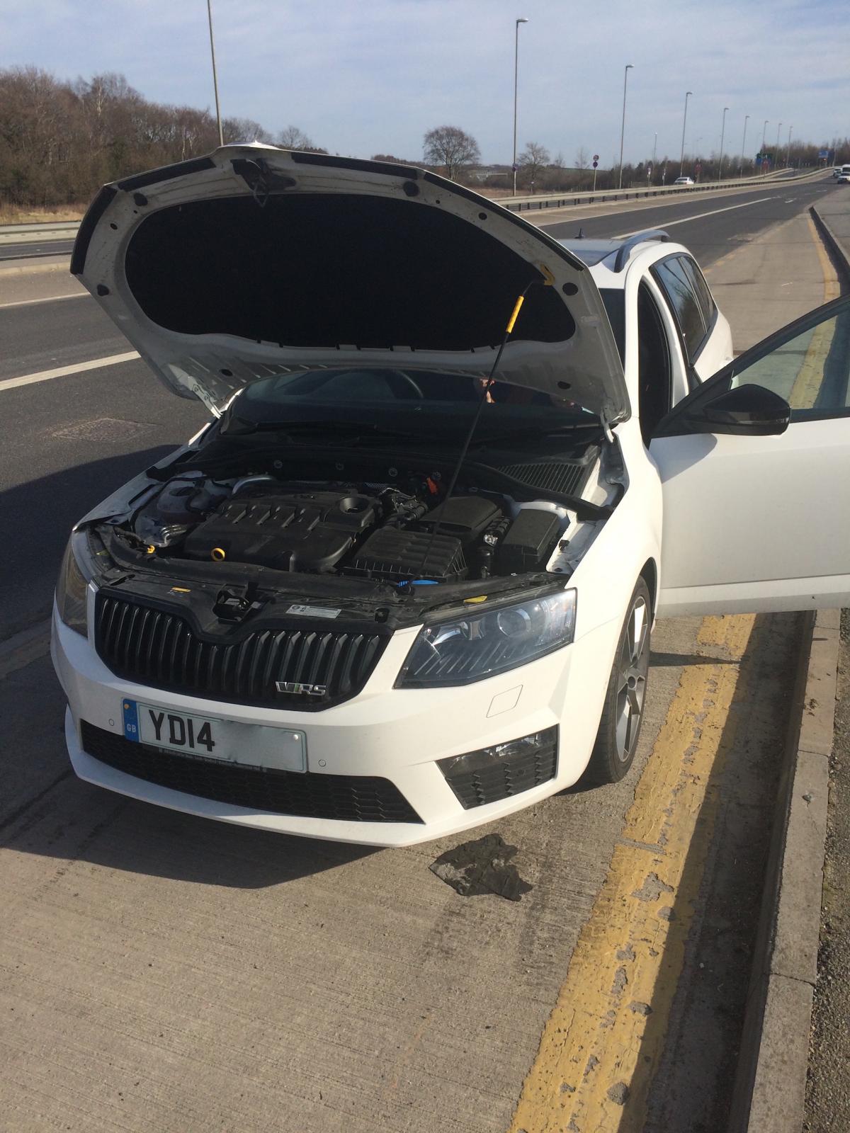

I am not one for freely venting my frustrations, but I do have to say that I am finally done with my VRS.
It's just about a year old and today, after a 10 min drive and literally the moment I got onto the Motorway, a warning message flashed up something along the lines "engine overheating - stop now". Temp gauge was at 130...so I coasted to the next exit and called Skoda assist.
The AA guy who ended up towing it to the dealership, thought the water pump might be the cause. We shall see....
I think I am just very disappointed as I really wanted this car to be a great experience and really...it has not been. The latest being just another issue in a long list of things.
Sorry Skoda... but it'll be good bye...
