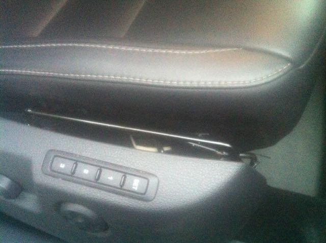

Is this the bar i need to bend ?
Yes that looks like the one, but you should be able to get the whole trim off to get a better look at it.  It runs parallel to the bolster, holding it up, so it's pretty obvious once the trim is completely off.

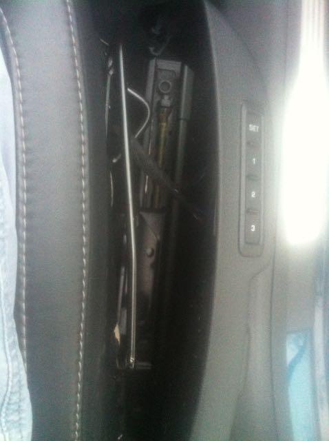

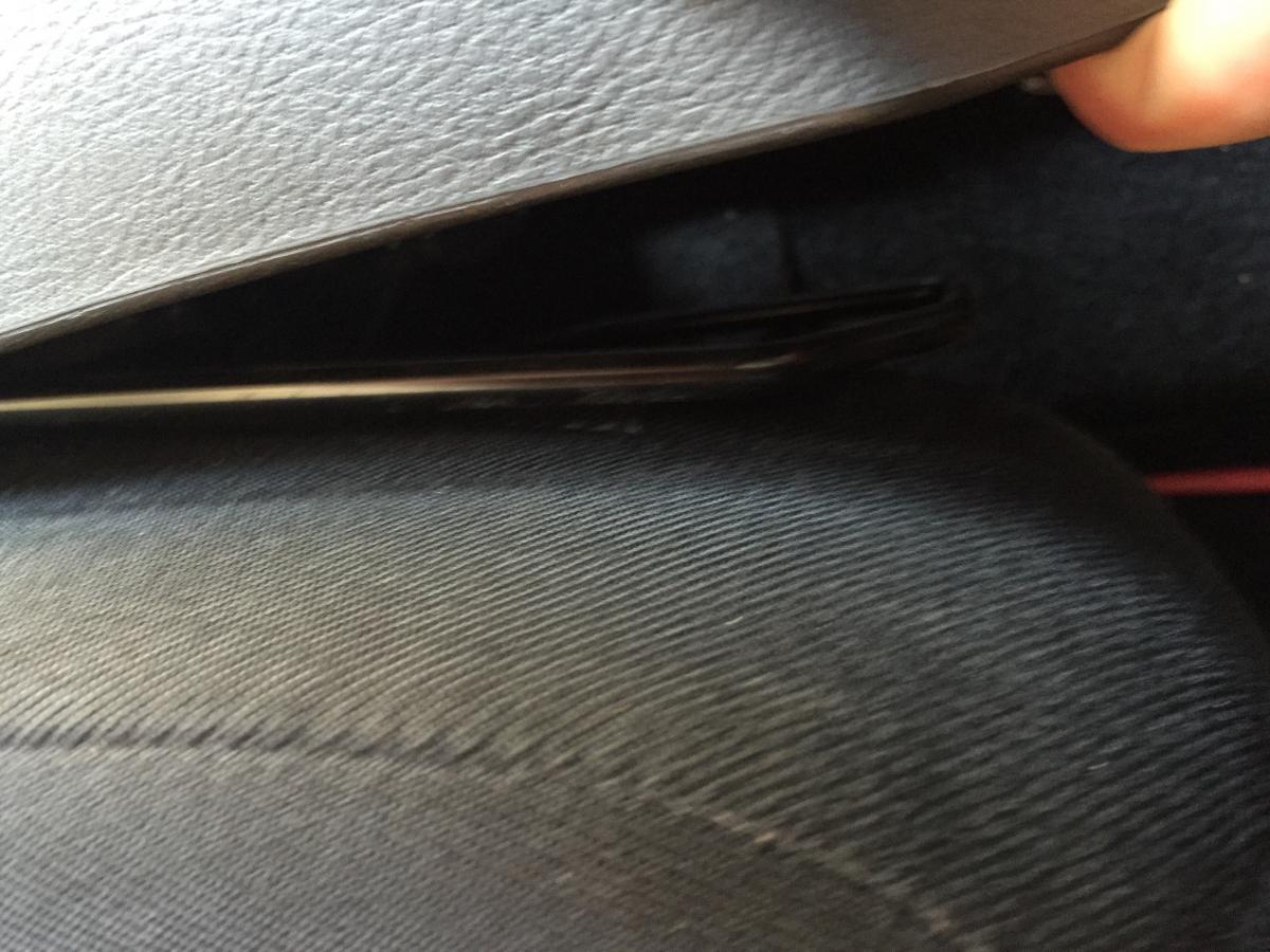

Just popped out to get some pics.  One shows the bar from the side of the seat, the other shows looking down while sitting in the seat.  As you can see there is now a fair bit of room for the seat bolster to spread out into.
The trim is unclipped in both pics.
