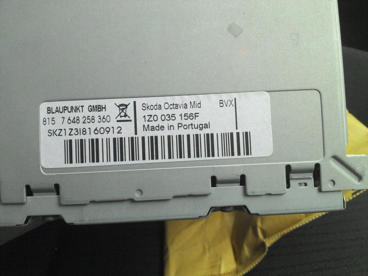

I'm at work so will get on it with VCDS when I get home late afternoon. If this helps I took photos of the stickers on the radio before it was plugged in.
