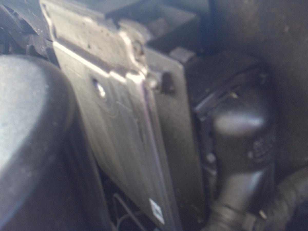

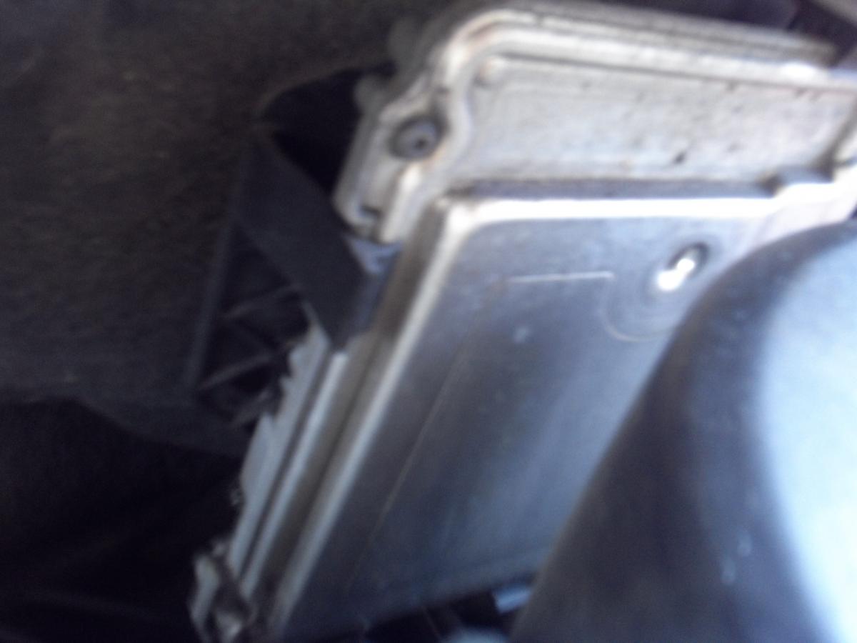

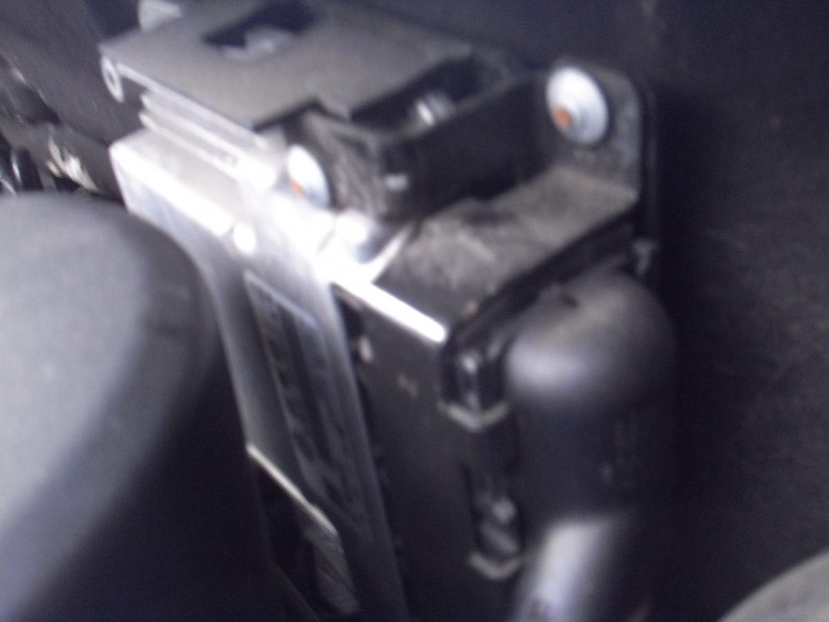

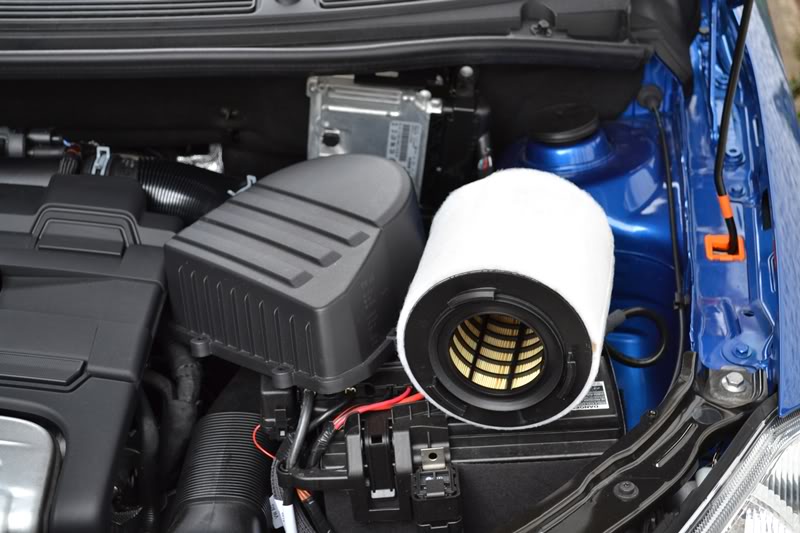

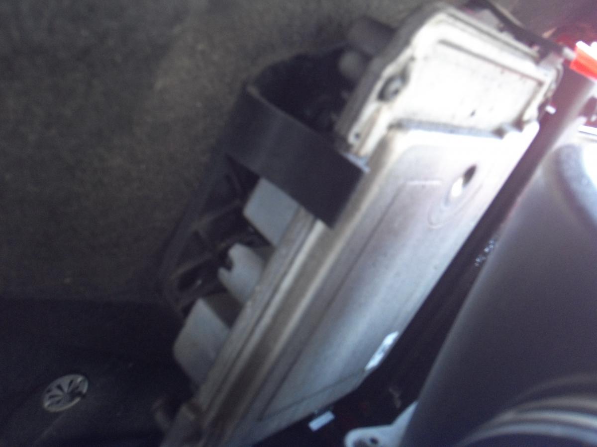

Rather than start a new ECU thread,
could i ask here anyone with a CTHE Engine vRS to post a picture of the ECU on their car and say when it was first Registered.
Or the Build Date if they know it.
As an Example these are an Early 2010 CAVE ECU.(3 pics on the left)
& then a clean 2011 ECU.  (from 'vrspowerd's Build thread) & on the right a CTHE ECU.
First registered 13/03/2013
Where do you find the build date, George?
Better picture - Maybe. Well, better than yours anyway. :notme:
Cheers. I was drunk as usual.
In the UK the Build Dates not too important it is likely to be a month or 2 before the car was first registered,
just interesting if its built late 2012 early 2013,  or mid late 2013-14, or later 2014.
