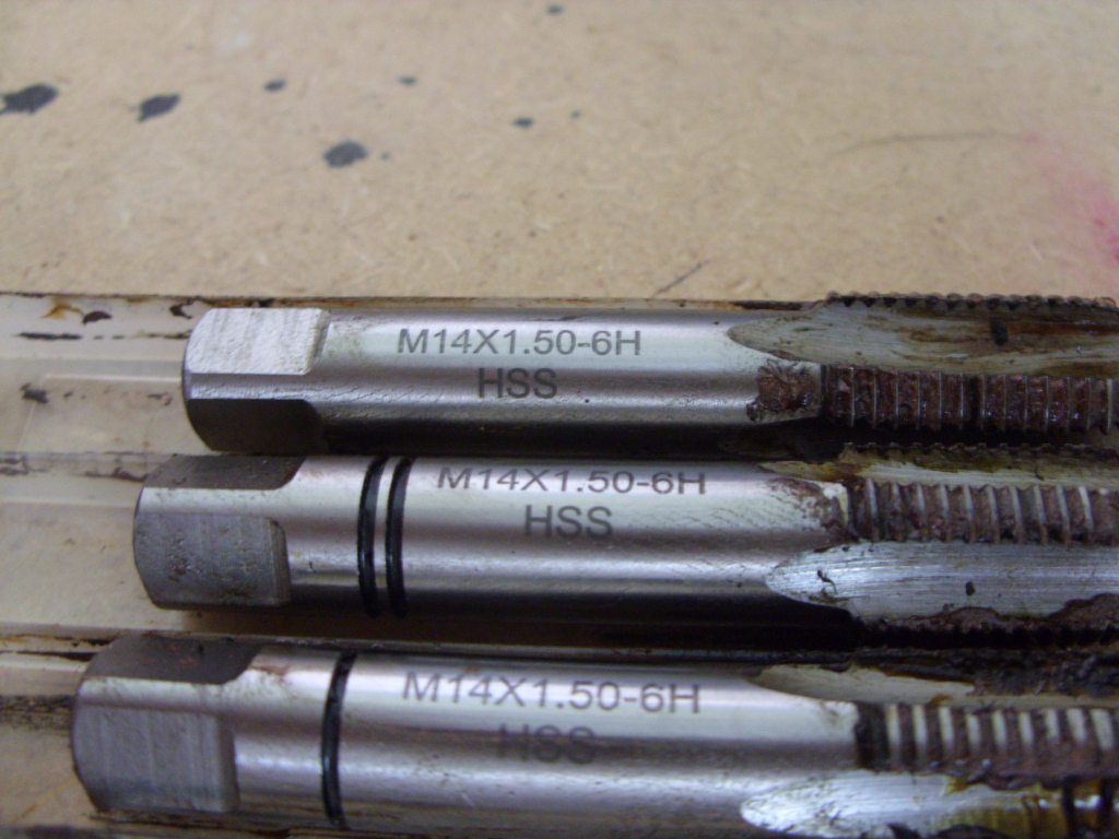

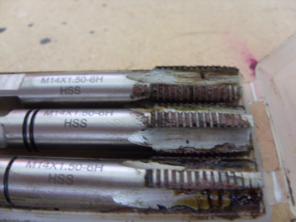

I bought this kit some years ago, thread taps start from minor cut up to the full thread tap cut.
Garage tyre guy, lost his popularity with me after I found-out what he had done, with wheel bolt thread...LOL
Bought the kit for about £10- £12.00 at an tool shop locally..(I think) sorry..
