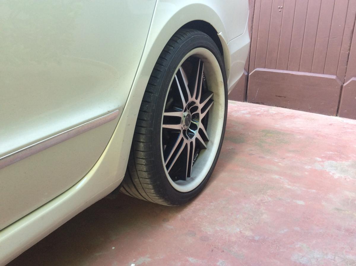

I ran mine on 19x8.5 ET40's, lowered 40mm on H&R Springs no problem.
I also had 235/35/19 tyres which are the correct size :thumbup:
As you can see on my pics, 8.5 ET40's take the wheels right to the arch edge
Perfection IMO :D
Thank you for pics Damo....
Hrmmmm i guess I have to take the 19x8.5 ET42 both front and rear then.... :thumbdown:  :|  Cool rims BTW  :thumbup:  Are they silver and white??

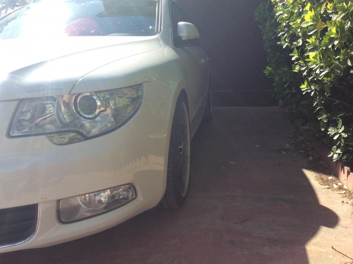

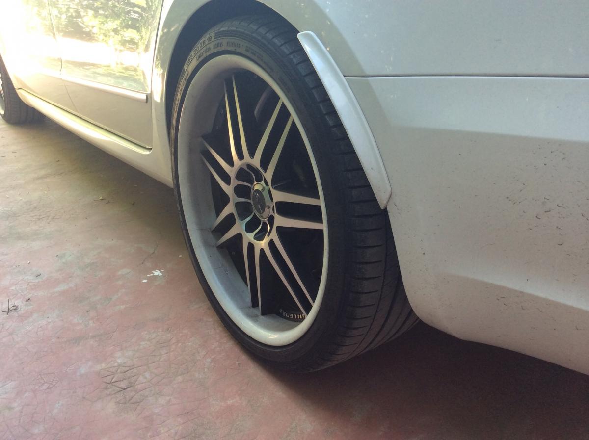

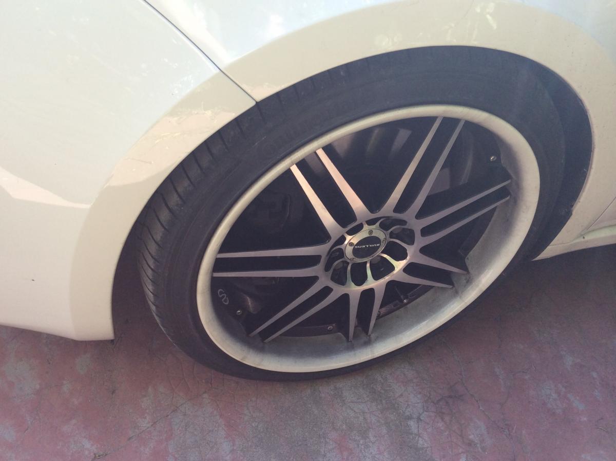

Hi KMDTHY - apologies in delay with reply.
I have just checked the paper work that came with the car (and the certificate of conformity for the 'controle technique' which you have to have if you change any bits on your car).
My alloys are actually 8x19 front and 8.5x19 rears with an offset of et36.
They are Japanese rims (Superstar 'Weds BVillens FE7' model code).

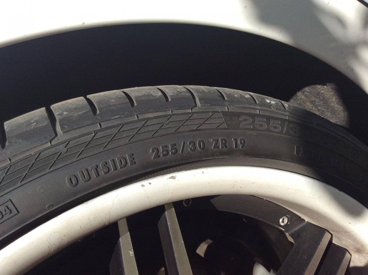

Tyres are Continental 255/30/19's
Funny thing is that if I had seen these rims on a shelf I would probably have walked right past them BUT on the car (fitted from new) they do suit it I think....it must be the white on white (and I discovered that the split rims were painted to match the Skoda white).
The car had to have small 'spats' on the rear to confirm to swiss legislation regarding rim width (the point Damo has indicated about rims going to the edge of the arch) and apparently these allow you to have wheels/tyres that go right to the edge without illegal protrusion (?!). Apparently this is common on cars with large rims here.....
Anyway, some photos attached....car a bit dirty as just driven down to Perpignan loaded up. Nice drive though ;)
Dave
Don't 255 35 19 catch on the arch when turning
I had read that somewhere too - on the outer arch/lip?
The problem I have had (apparently) is not the outer arch but the inner arch....although no real evidence to confirm this (rub marks on tyre or inner wing etc.).
