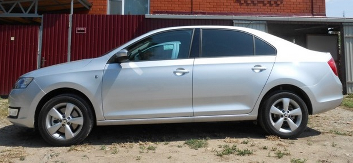

We have here in Russia and Ukraine lifted suspension (like 15-20 мм above euro suspension) which is not good at all). The only difference from euro one  I suppose are coil springs. So I am looking for information which coil springs are fitted on euro rapid (1.2tsi manual and 1.4tsi dsg)?

That's some arch gap. There are quite a few on here who have had theirs lowered so I'm guessing that there are quite a few sets of standard springs in circulation

Is that a Scout model [emoji6]
Yes, I aware of eibach and h&r but standart euro suspension looks like a compromise here. Not to low and to high. So if anyone could say what color marks are on yours coil springs it would be helpfull.

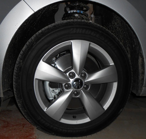

On our MY15 1.2TSI manual :
Front springs are 6R0411105B, 3 white & 3 green colour marks
Rear springs are 1J0511115AM, 1 silver & 3 green colour marks
[ The front spring pictured above ; 3 white & 2 blue colour marks --> 6R0411105F ]
