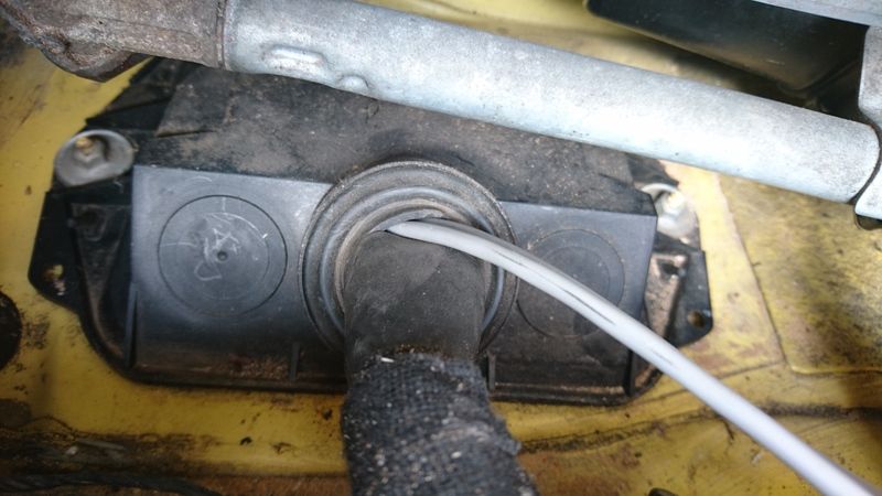

Wiring for both senders were passed through the bulk head by putting a slit in the rubber boot that takes the main loom through to the internal fuses and relay packs. I used some tiger seal to make the rubber boot water tight once job was finished
