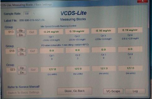

Here's some vcds info if it helps. One where there were no issues, and one where it gone bad.
Codes I get were PD Unit Injector: Cylinder (1, 2 and 3): Regulation Range Exceeded
I'm actually thinking it might be the loom from the injector loom back to the ecu?
