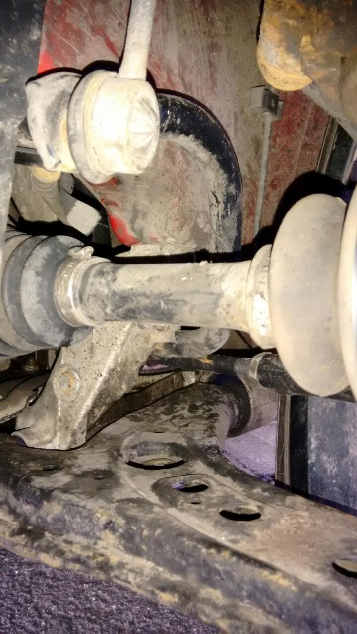

But steering now intermittently sticky, with a fair bit of resistance to turning wheel, particularly on left full lock. Sometimes a metallic knock grind at full lock together with the resistance. Really not sure if this was present before all the changes I've done as steering/suspension was far from great, but I think it was.  Had a quick look under car and seen there is contact between the FARB and the track rod on left side on left full lock.
Don't think it is a drop link issue: pretty sure its had shorter drop links fitted by Dan, and contact is right near the bend of the ARB.
Going to have a good luck underneath tonight, but anyone else had similar issues, or better still have a solution?

Picture attached. The contract point I'd the tiny orange rusty spot on the track rod
if running KW's fit standard height drop links i don't have any issue with mine at all

The steering is 'sticky' at all sorts of points:  particularly turning left, but also straight ahead. Checked FARB to track rod clearance and it only touches at full lock and driving uphill (which is how I checked it this morning), so don't think this is causing my issue.  Straight ahead there's loads of clearance.
