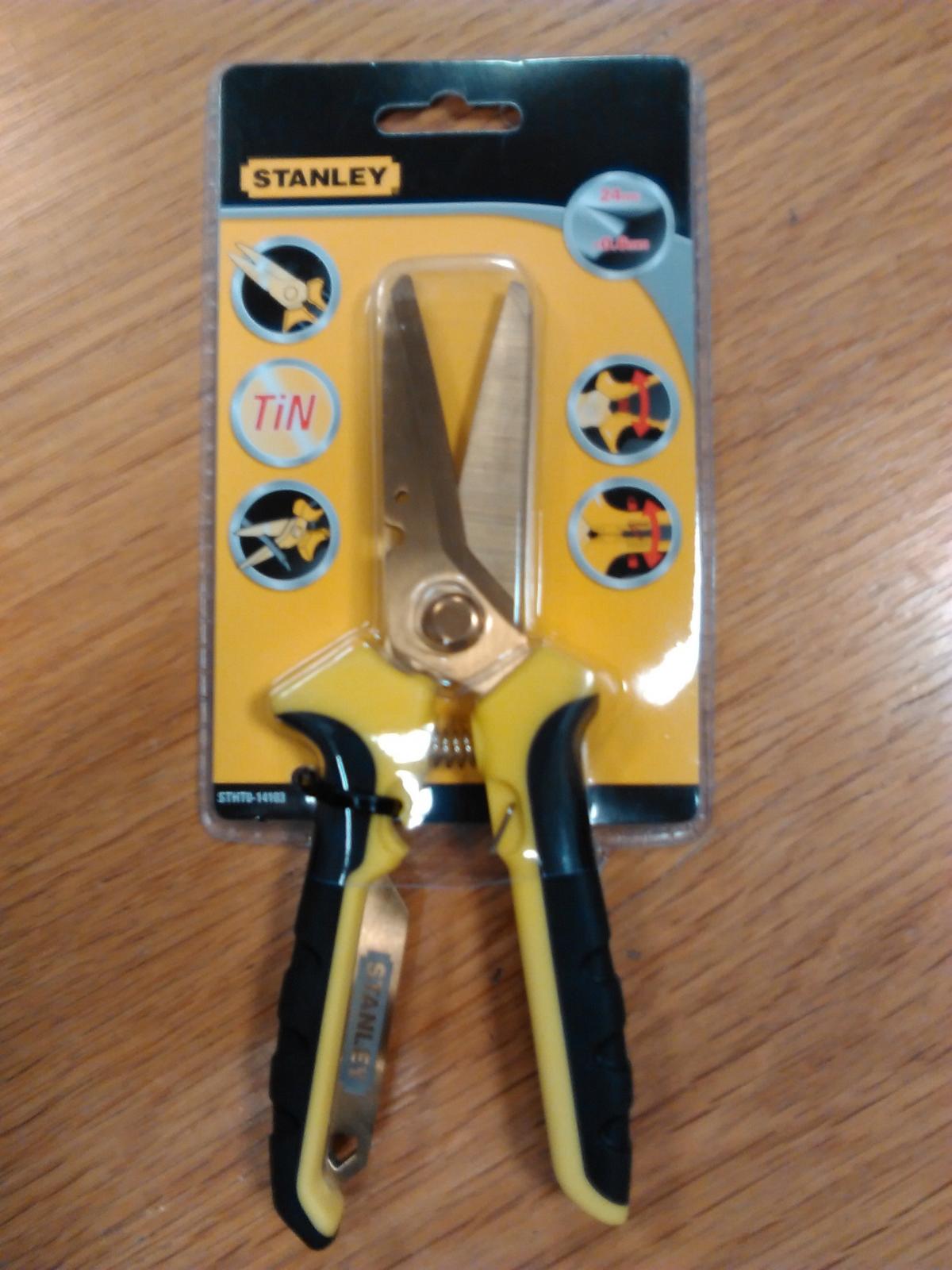

Preparing for the worse (i.e the hub needs removing) I've just picked up a pair of tin snips :D ...
