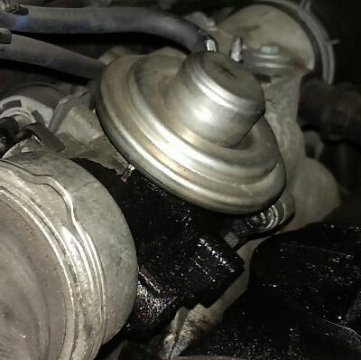

Remove and clean or delete
What mileage was your car on when the valve was in that condition ?

No worries dude good luck. Get some pictures up when you get the egr off
Cleaned mine out mileage was 115k then, it was like tar and loads of it, I used a screwdriver and kitchen roll (loads) and every now and again it still weeps oil from a hole on the EGR valve, I just wipe it away, I also used oven cleaner to remove some of the oily deposits. Mucky job but worth doing, my car is on 150k now so cleaning with help it. Happy cleaning.
