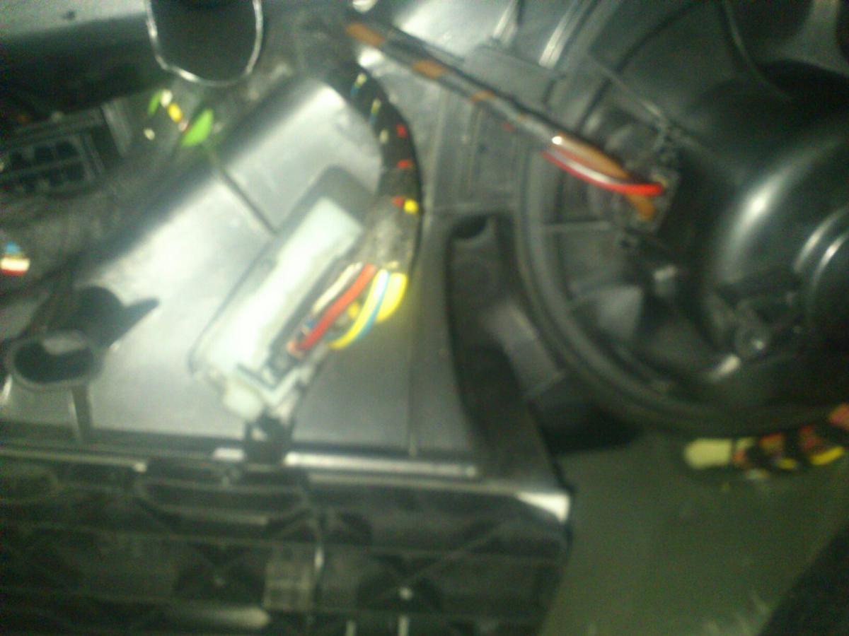

Did everything as suggested, cleaned the cabin - air filter from stuff inside (it was kinda' dirty), still nothing changed and continues to make this noise when ignition is ON (although the cooling is on 0 - OFF). It seems to me that the round covered part on the attached picture should be the fan, but I'm not sure how I can open it in order to check of the propeller itself...Please advise on this!

Is it also possible that the cause could be some relay? Is the relay box placed near/ behind the glovebox somewhere?
