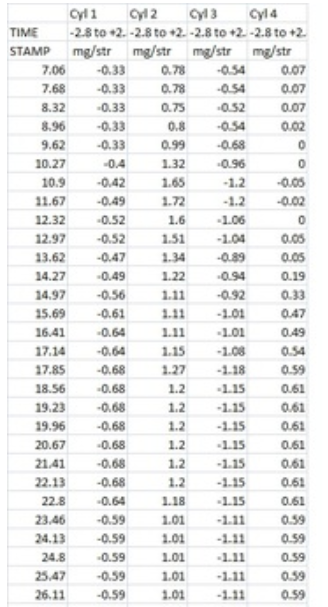

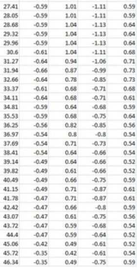

I've ran a log of measuring block 13 and it doesn't seem to reveal anything that I can see.

in that first log injector 2 looks to moving out of sync more then the rest 9(s this logged at idle or driving)

So now the injector units are coming out to be sent to United Diesel for testing.  I suspect a broken body or something.  I have no idea how to interpret the fuelling logs so can't comment on that.
