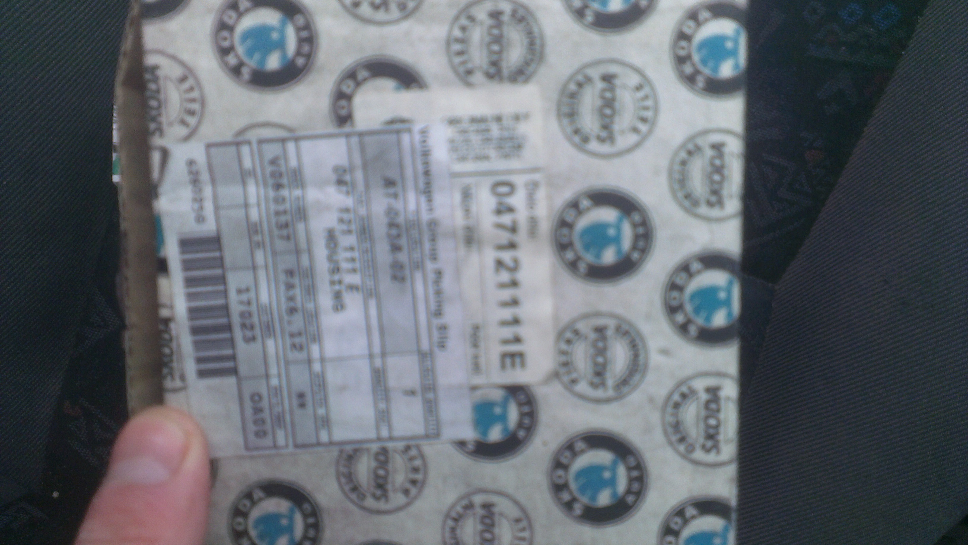

Thank you so much. I think I have the 135m but will check again in the morning before I order.
Got the genuine skoda part 'E' for the lower output 135m from eBay seller for 21.50 GBP. Much cheaper than I could find the higher output 'A' part.
According to another vendor the E model part is for the older carburetor engined Felicia, and will not fit any MPI engine. The A model part fits all MPI engines regardless of power output.
I have already ordered the E part. I'll have to see if it is any different when it arrives. Maybe I will need to buy the A model part and sell the E model

It works! Thanks richardo m
