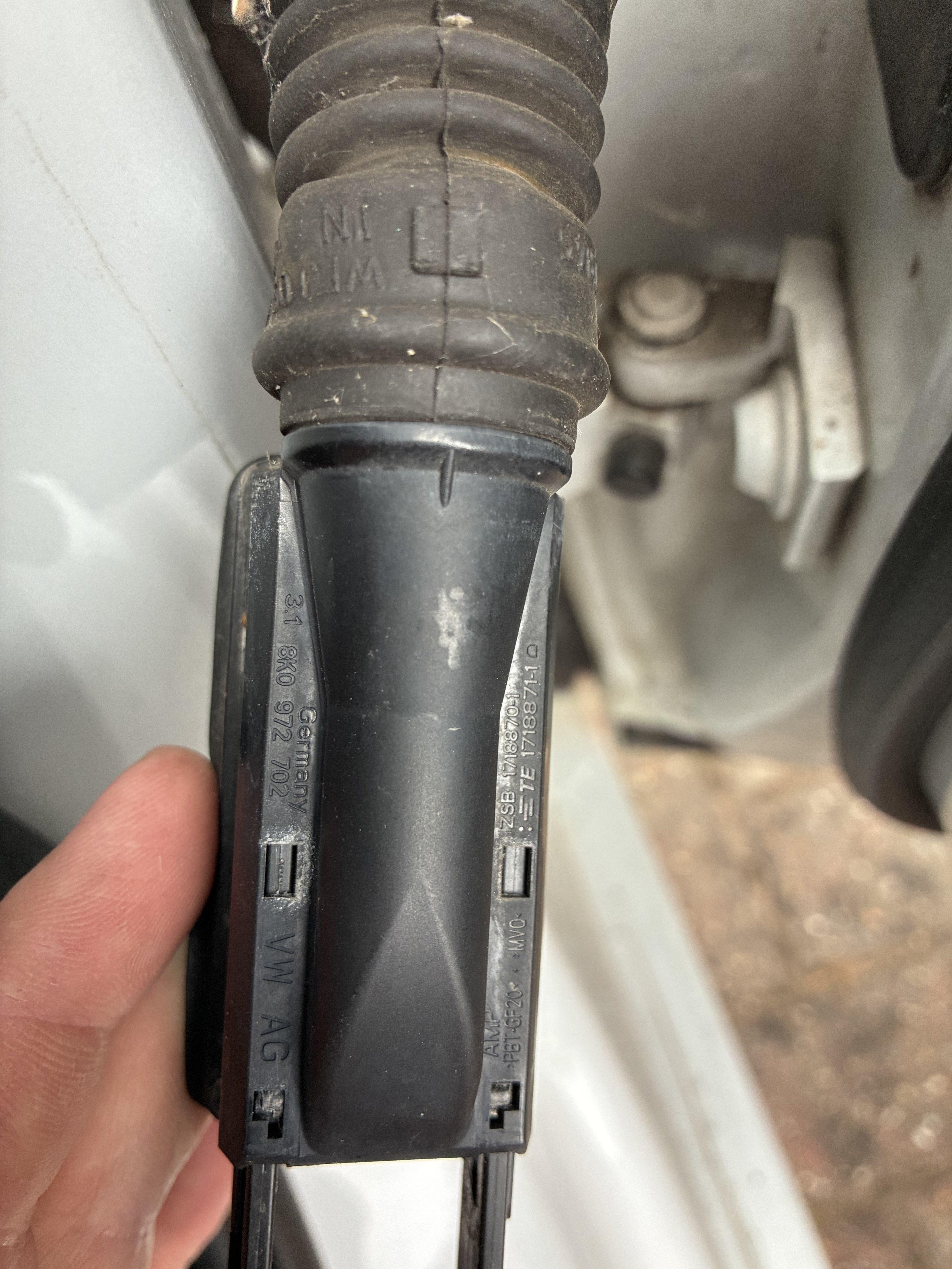

Could be corroded pins in the multiplug which slides off the window motor, or damage in the loom. The window regulator can also rub the loom as well which doesn't help.
