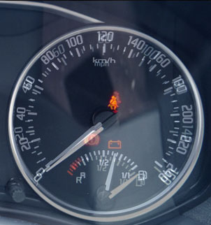

Petrol maxidots?
I think they're maxidot going off the part numbers, but the speedometer is in KPH as they've come from Ireland.
I'd be surprised if it is a Maxidot.
The listing says it has come out of a 2009 (FL) Elegance. Maxidot was a £135 option on the Elegance, although it was standard with DSG.
The listing doesn't mention whether the car was a manual or auto though.
I wonder if Maxidot was standard on the Elegance in Ireland? As a general rule the Irish cars had a higher standard spec.

The part number is listed as 1Z0920843B
According to PartsBase, this is:
combi-instrument; display unit for maxi-check; package; BUD,CAXA; BSE,BSF,CCSA; CHGA; CDAA,CDAB; PR-U4A+9Q2
So it's a maxidot set of clocks.
It's much harder to tell from just pictures on facelift clusters as they both have a full size LCD unlike the pre-facelift.
Edited by softscoop
I'm pretty sure the dial faces should swap across from the current clocks of the purchaser?
Are the numbers in the same place? Or can you tell it whether it's got MPH or KPH face?
Dunno if this helps work it out? I know I can change mine to display mileage in KM. Maybe the big display will show MPH and the person could live with that.
I think the range is different.
Looking at the top we have 80MPH roughly level with the chrome trim, the kmh clocks has 120KMH in the same position. 120KMH is about 74MPH, 80MPH is 130KMH.
240kmh is 150MPH (149.129 to be precise).

It seems odd as both vehicles should theoretically have the tame top speed, the difference between 0 and that top speed on the dials is the same so surely the increments between them should be right? I confuse myself with this stuff, its borderline maths...I'll have none of that thanks!
