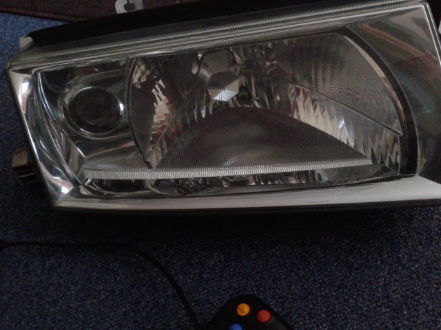

Front lights.... wouldn't adjust much so whipped one out. The up down adjuster was wound all the way in.
still doesn't seem high enough so I'm wondering if the bit which moves has dropped below the frame... pic added, video to come.
It sounds like the ball at the end of the adjuster has become detached from its socket on the reflector, if you remove the headlamp you'll be able to see more.

I can detach / re attach the ball, but from the video / picture is that how the headlamp is meant to be? or is it meant to sit on top of the shelf it hits when I move it around?

So, I've adjusted the headlights to the highest point, Hope this bloody works.
Having had some problems with the beam adjuster motors in the past I have a couple of dissected headlamps if you need inner bits or photos thereof.
