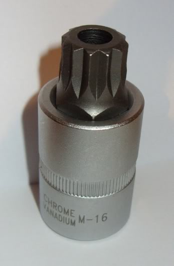

You will need a special splined socket (see attachment) mine does.
