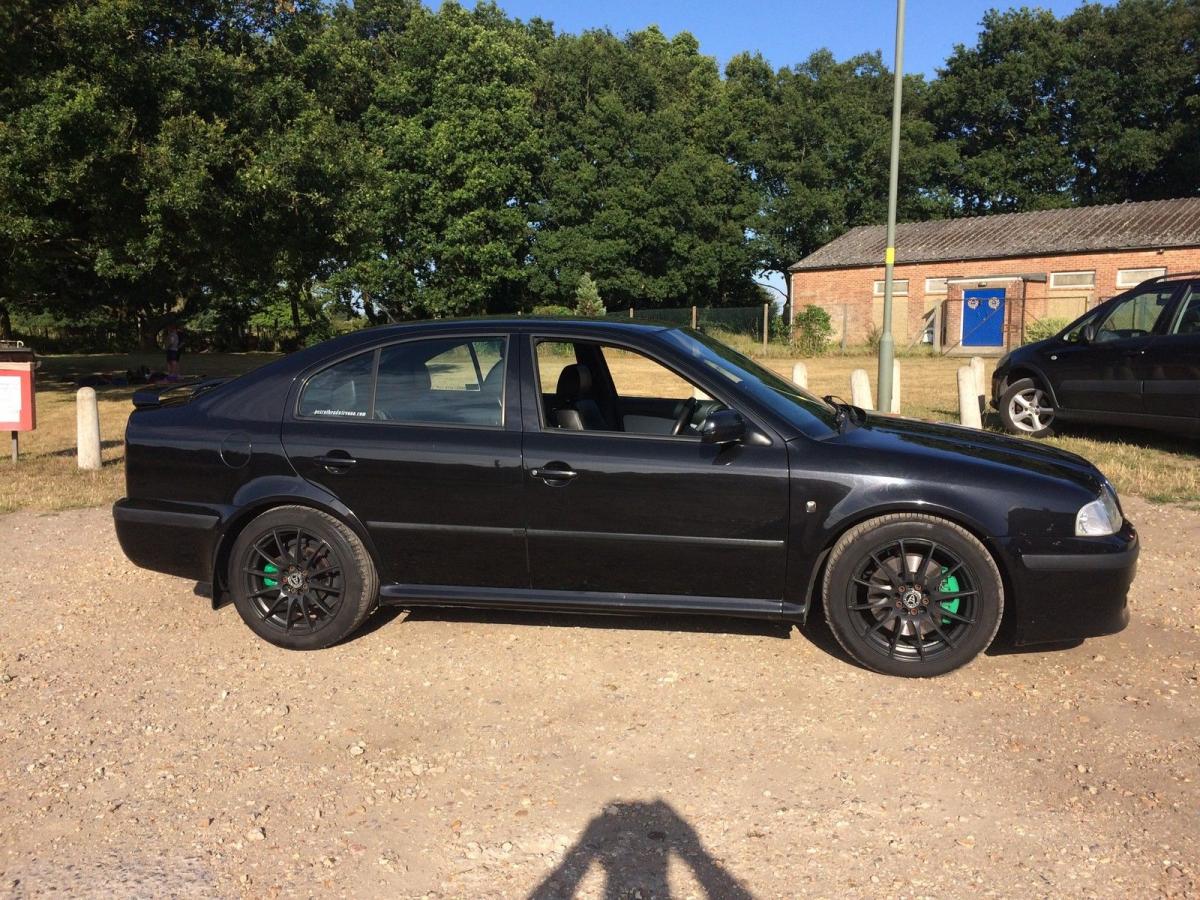

Hi gents, realise that this topic is a bit old but I am looking at getting some lightweight alloys for my vRS. Here is my car:
Could someone confirm which wheels these are? They are the 18" ones, so I assume that they are 7.5J? Anyone know the offset?
I'd want to remove the tyres from these and fit them to new alloys if they are still usable, I had OZ Ultraleggera on my last car and really liked them - luckily it sounds like they are suitable.
Any other suggestions?
7.5" ET52 I believe
