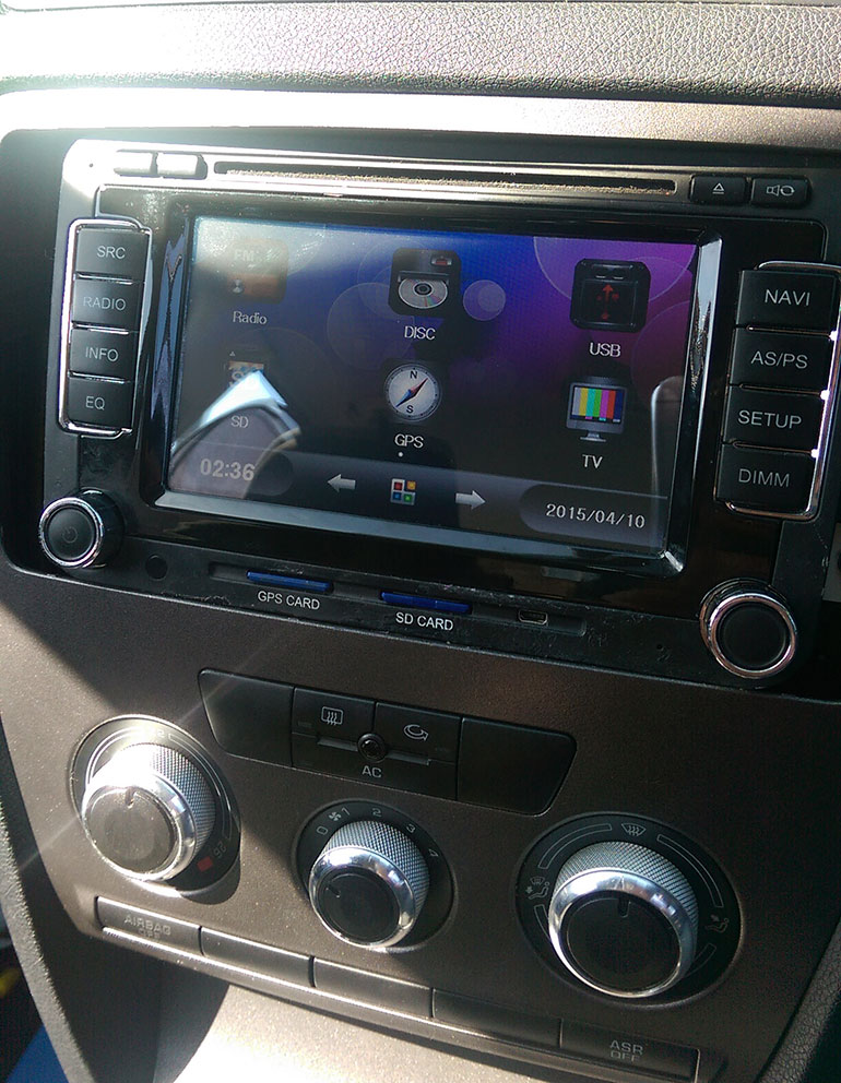

I have an old Chinese unit that I messed the nav up on, has can integration etc. Does sd cards up to 32gb, also has a brand new numberplate surround reversing camera, bluetooth with external mic, another video in for dash camera etc. The nav can be fixed if you can find the firmware. £75 posted if you can use it. I even have the surround to go with a car with climate. I turned the navi off from the secret menu but if you can get it fixed might be useful, it is Wince6 so a bit slow on the navigation front. Bluetooth works brilliantly though
