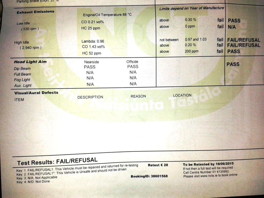

I'm looking for an advice on my Skoda Fabia failed emission problem. It's a 2004 Skoda Fabia Combi 1.2 Classic, Engine no: AZQ517707.
It failed NCT test (Irish MOT equivalent) on CO emissions and Lambda sensor on High Idle (please refer to the pic attached). My mechanic tested it after the test and said it's a faulty Lambda sensor (pre-cat one)  and he reckons new sensor should do the trick and car will be up to the spec again. I checked my local part supplier where I get all my parts and he said Lambda sensors is something they stopped supplying because it's nearly always wrong and only main dealer would get me correct one. Main Skoda dealer is looking for 204 Euro for it.

I honestly don't know for sure that changing this sensor will fix your problem; how many miles has the engine done? Do you have to top up the oil much? Engine wear tends to lead to oil burning, which tends to clog up lambda sensors and catalytic converters.
Does it drive OK?
I'd say to test the lambda probe before replacing it. Usually, it is the pre heating system which fails at the 1.4 mpi models, but once the engine is heated up and, they do run in the specified parameters. Check the catalyst as well.

I'm pretty confident that is the same sensor that a Skoda dealer would sell you (where do you see 5-pole?). Phone the ebay seller to confirm. They're a legit company and will tell you if it's not the right item for your car.

Are there any codes on the ecu?

To the OP, in other words, get a full scan done and see it that gives any clues to what is not right.

My ECU was pretty vague ragarding lambda probe issues, it was saying about something wrong in the circuit. So I had the circuit tested, retested, the connectors cleaned and so, and after about 2 years, it started saying about heating system. I also ran the VCDS tests for the two lambda probes and the catalyst, and suprisingly, it said the first probe was running fine, same as the catalyst but the very last one was found as being faulty. I wouldn't really solve this issue only by reading the fault codes.

Hi Lads, I owe you explanation on my Skoda emission situation.
I got the new lambda sensor fitted, emissions tested, and car passed the NCT test today with all the values within the range. It cost me 205 Euro, the sensor plus work, so I suppose it wasn't bad after all.
@Wino @Alexandru re the oil consumpiot, my mechanic said the faulty sensor caused higher oil consumption. I'll have to monitor that, and see how much oil did it use after 1000 kilometers. I'll wait with the compression test until I know how much oil it actually uses.
