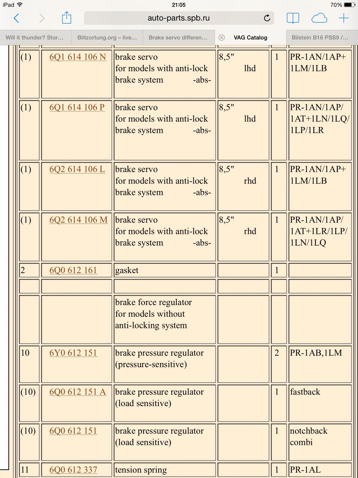

Does anybody know if the brake servo is the same on the VRS as it is on the pd100?
I know that the brake servo assist can be changed in VCDS, but when i tried, it wouldn't let me access the controller (genuine VCDS)
no idea but I have both if you need 1 I can check part numbers tomorrow if needed
thanks  mate but i wont be replacing it on my car, it is literally just out of curiosity, as every vrs i drive, the brake are a million times better than mine  :envy:
There are 2 variants of the part number George, both for cars with ABS, but doesn't say if it's different for different engines.

VRS has 288mm discs, you're on 256mm in the PD100, I believe the servos are pretty much the same across the entire range.
that's why they are better then I would have thought they were the same myself just different size disc and calliper I got a set forsale if interested :)
